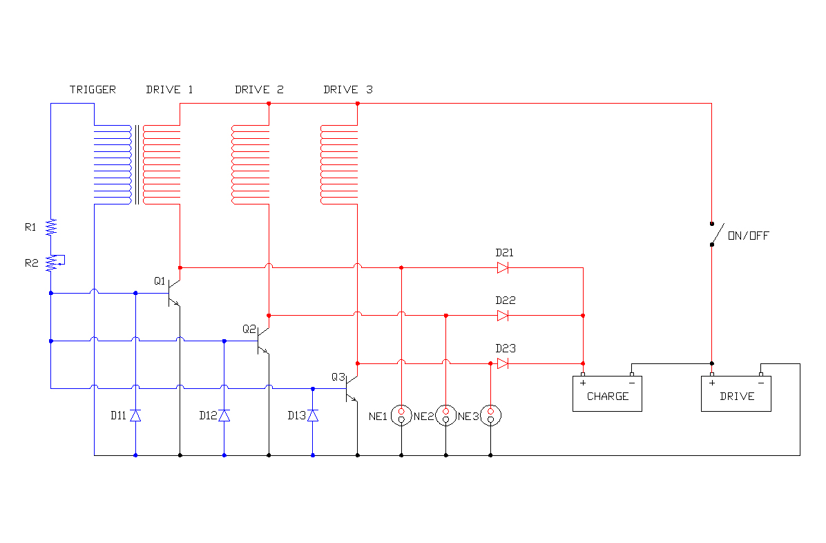

                  I found some time amongst my holiday madness to redraw my schematic, hope it helps.
                  happy holidays all

                      transistor resistor
                      Originally posted by kippered View Post
                      Well I took 2 steps forward, 1 back and then 2 more forward tonight. Thanks to some observations with my scope I found out that I had wired up my trigger circuit wrong and was not getting good firing on 2 transistors.
                      What I did was use 3 pots and 3 resistors, 1 each to control each transistor... well that split the current in a way that only 1 transistor was firing full on no matter how I adjusted things. Now I have 1 resistor and 1 pot controlling all 3 transistors and the results look much better
                      That is a strange result... unsure myself but it might be wise to try a different battery before getting to far ahead.
                      have you tried using one resistor (220 ohms 1watt for 12 volt) at the base of each transistor - then to one pot then to trigger coil? once tuned try replacing pot w/ resistor/s series and/or parallel.
                        Not that exact config yet but I will give it a shot just to see if any differing results occur. Unfortunately I will not have the chance until next year due to the holiday season.
                        Thanks for the input

                          • #28
                            Originally posted by Shanjaq View Post
                            Something to watch out for: Transistor's Vceo and/or Vcb ratings MUST EXCEED the target potential on the charge reservoir, otherwise the transients will start to see the Transistor as a more favorable path at some point beyond the max rating. It simply can't provide sufficient pressure to push through the diode on the Collector, so it discharges internally... This only becomes a problem when you're trying to desulphate a battery using capacitor discharge method...
                            Also, just to speculate about DC Current Gain(Hfe) vs the Switching Speed(Ft): Transistors are Current-Controlled Devices, and your Trigger Winding is providing the Base Current as a mostly AC Waveform, which leads me to believe that it is the DC Current Gain which will give you the sharpest Rise-And-Fall Times on the switched output. An average Switching Rate (Ft) in the MHz range should be more than adequate to render such a curve which is ultimately determined by the induced current in the Trigger Winding.
                            Hope this helps, ideas?
                            I am inclined to agree with you. As you mention the diode on the trigger is essentially a 1/2 wave rectifier so you will see half a sign wave to the base of the transistor. At the frequency rate the slope would be relativly steep but if the Hfe was low it might take that extra fraction of a second to turn fully on, or more importantly fully off. I have planned on looking into some idea's for driving the trigger circuit harder... any idea's? or do you think a good Hfe should do the trick?
                            I read the other SSG thread about using a bipolar switch to help with switching off. I need to get an understanding of how the pnp helps switch the npn off faster. More to read up on I guess
                            I also played with the kit for a few minutes tonight (much to my wife's dismay) and found out that my trigger circuit does not work right still and it drives one transistor harder than the other two.
                            I will test but I think it proves minoly right that you need a standard base resistor that is the same for all 3 transistors so that the current divides evenly amongst the 3 transistors otherwise it heads for the transistor with the least internal resistance and drives it harder.

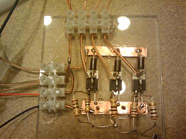

                              Just a quick post of the driver circuit build in case anyone wants ideas to tighten things down. All speaker wire and direct connections bounded with copper embossing foil and glued to a sheet of acrylic with terminal blocks for convenience
