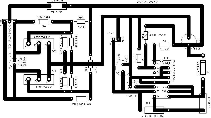

                      PCB Board help
                      I was trying my luck at making my first PCB. I would like to make this Ozone generator here and would like someone to look at it and let me know if it would work. Have made a few circuit boards but I had a big mess of wires running everywhere. Also something was mentioned about a 3 watt 3-5 mohms resistor put in. Where should it go?
                      • #26
                        Hi reddb49,
                        looks good. To test it, just solder the voltage step up part first and see if it can be adjusted from 12-28V by turning the variable resistor. If yes, solder the rest of the circuit. The 5MOhm resistor goes in series of the HV output of the flyback transformer. It limits the high voltage to some mA current, this breaks the arc and makes a fine steady ionization. If it is not there, an arc could jump from positive electrode to ground grid and sustain itself drawing lots of current and doing no good. So it is essential that this resistor is put there.
                        • #27
                          Thanks Jetijs,
                          I will get the board and fluid first part of the week, get it printed out and get my parts ordered from Mouser. Might take me a while to get the board like I want but will get there. Thanks for the info.
