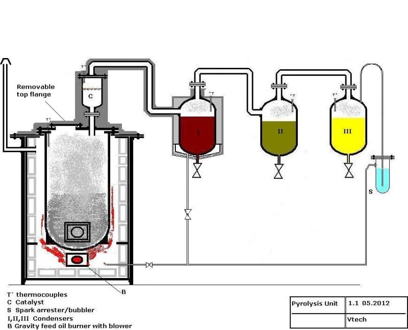

                  thanks lmakebiodiesel l understand well know l hope l do it thanks l was going to do it like this on the picture what u thing?
                  • Your design looks good but the pipe that exits the top of the reflux should slope downwards to the first condenser. That way any condensing liquid will flow quickly into the first condenser rather than fill up the pipe and cause a blockage.

                    • Originally posted by imakebiodiesel View Post
                      If your oil burner is the type to cycle on and off then you must not direct the uncondensable gases into the furnace. The burner would cycle off for a while, the gases would fill up the furnace and when the burner came back on ...kaboom!
                      I could be wrong, but I'm proposing that the pipe out of the reflux should sloped upwards. Isn't it more precise for liquids to roll back into the reflux column rather than risk heavier fractions going where you don't want them?
                      Also, regarding the return line of uncondensable gases, wouldn't a pilot light solve/minimize the potential risk?
                      I also see a line going from first condenser to boiler. I think it opens up a risk of sending fractions that are too heavy for the boiler, plus potential clogging of pipe. I think this should only be done after testing the system extensively and ensuring the risk is very low.

                      • Originally posted by Marso Green View Post
                        Isn't that line used to supply noncondensable gases for heating the first condenser if required? Please correct me if I'm wrong.

                        • Originally posted by Excalibur View Post
                          It seems to go to the main reactor, but I could be wrong. The diagram can be interpreted in more than one way. But whether the line carries noncondensable gases to first condenser or reactor is independent of the issue of connectivity between first condenser and reactor. Perhaps someone can explain exactly what it's supposed to do, and I believe that counting on the condensate from first reactor to fuel the reactor is high risk without insurance that it is the correct fraction for the burner used

                            thanks for every one l makebiodiesel thats not my design l post that design to see if it was good ok thanks for help l make that pipe downward. is there any size for reflux my retort is 50 litres geyzer l was going to mae the reflux column about 3 inch wide and 12 inch long is that good? thanks

                              ok that gas that come from bubble goes to heat first condenser and goes to heat retort thats not my design l want to try it l dont thing there is anough gas to fire 2 burners
                              • The idea behind the reflux column is that any vapour that can make it to the top is fully cracked so the downward exit pipe ensures it does not flow back into the retort.
                                Sizing a reflux column is a bit of a black art. Your dimensions sound about right, tall and narrow is generally better than short and fat.
                                You are right about the amount of gas, it will not be sufficient to heat the first condenser and the retort. The design shows two valves that would allow you to control how much gas went to the condenser to get the right temperature and any excess would be diverted to the furnace.
                                A pilot flame or something similar would solve the problem of gas building up in the furnace.
