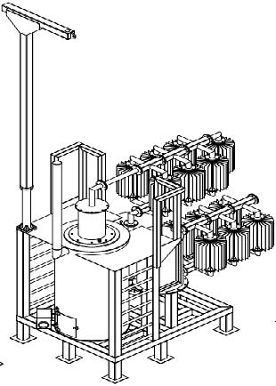

I would like to share with you the info that the pyrolysis unit you can see in the picture will be ready for first tests at the beginning of January, 2013. I will share information on this thread about the capabilities of this plant with pictures, videos and test results. The plant will be installed at landfill area where they have plastic sorting. The capacity of this test plant we will plan approx 200Ltr or 100kg per cycle. Dimensions - 1,5mx2,0x3,0m (without lift beam ccinstruction). As reactor material we use thermal resistant stainless steel with very good insulation from outside.
Best regards.Last edited by Gints; 12-04-2012, 06:26 AM.

your reactor looks very well thought out. The picture is very small and is hard to make out. It appears to be a cylindrical retort heated by an oil or gas burner with a reflux chamber above. the output from the first 2 condenser is returning to the retort for recracking. There is another vessel and a set of condensers at the back, what are they for?

There will be following production steps - reactor, refluctor, heat exchanger, product tank 1, heat exchanger, product tank 2, bubbler, the rest gas goes to burner chamber. So there are will be two stages if it is necessary to go further with condensing process.Attached FilesLast edited by Gints; 12-04-2012, 05:28 PM.

Gints, those views are much better. With that out fit you should have good control of the quality of the final products. What fuels do you intend to produce?
I can confirm from bitter experience that terephthalic acid solidifies in condensers. In my experiments with PET I almost blew my self up. About half way through a 1kg batch my bubbler suddenly stopped, always a warning sign. While I was trying to figure our what had happened, I suspected a leak, the steel pipe between the reflux and the condenser split open with a loud crack. The welded joint had failed under pressure, which was just as well because if my welding has not failed the pressure could have built up further and my reactor could have exploded.
Later when I took the outfit apart to repair it the pipe and the condenser was completely clogged with what looked like tar. Terephthalic acid may not be very toxic but that does not mean it is not dangerous.

The batch size was 1kg and the exit pipe was 1 inch. At the time my pressure relief valve was positioned at the top of my reflux column so it got blocked as well. After that incident I fitted the pressure relief valve on it own pipe direct to the retort, a much safer arrangement.
Im aware that there are ways to avoid the problems of terephthalic acid but they are a fair bit more expense and trouble. Clean PET currently is worth 940 euros a metric ton here in Europe which means that if you subtract the tax on fuel, raw unprocessed PET is worth more than the fuel you could make from it.
Soiled, unsorted PE,PP and PS on the other hand is worth almost nothing and is ideal for our process. Thats why my short answer to Pravins question was no.
With this unit I will plan to crack only PE, PP, LDPE, HDPE materials. Also in the pressure sensor will be installed in reactor. When the pressure sensor is triggered a rise in pressure system, the entire system will be switched off.
Thanks for the idea you notice about the bubbler. I think somewhere can be kind of gas meter installed. In cases where the meter stops, the unit also will be switched off.
