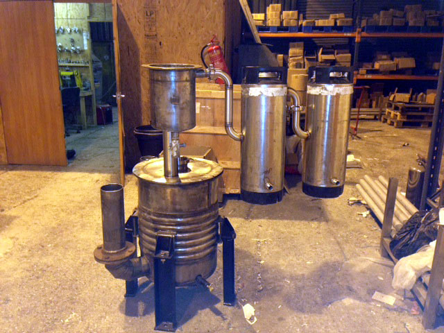

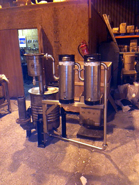

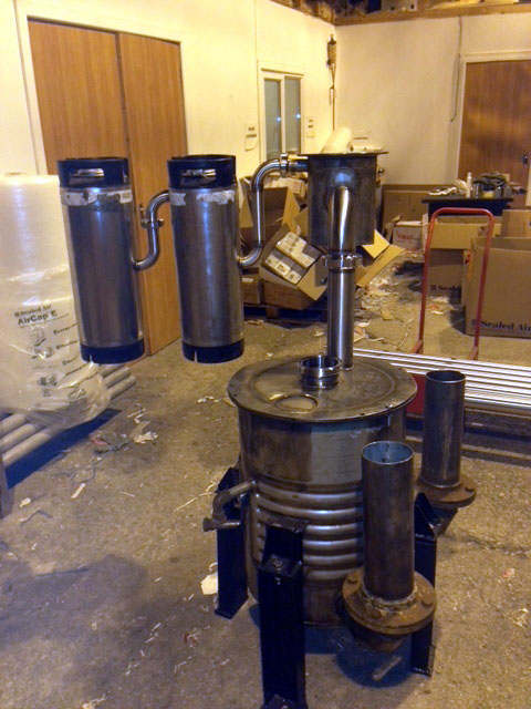

Nice photos waterboost. What are you using for seals?

Seals
I think the seals are all stainless compression fittings.
The loading access one on the reactor top will have a glass fibre high pressure furnace seal.
The only one that concerns me is the tap fitted to the first condenser (basket filter) which I amicably refer to as the cheese pot, even though I hope not to see any cheese in there... I havent checked it yet, it may need replacing for an all metal ball or gate valve...
