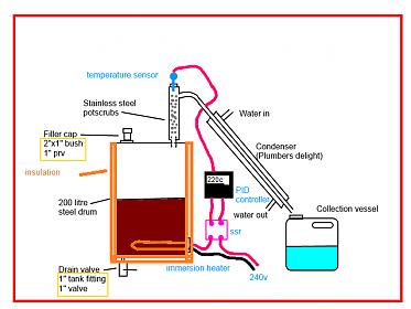

Originally posted by ndsunil
I think the total reaction using 30Kw to start will need about 6 hours to melt and heat everything, ignoring latent melting phase(added an hour from 5 hours for melting and heat loss ) then about 4 to 5 hours, at present about roughly 12 hour run if everything works out okay
P = ?
m = 500kg
c = 2700 J kg-1 oC-1 (approximate)
θ = 400 - 25 = 400oC
t = 18 000 seconds(5hours)
We assume,
all the electrical energy supplied = heat energy absorbed by the water
Pt = mcθ
(p) 18 000 = (500)(2700)(400)
P = 30 000w or 30kw
