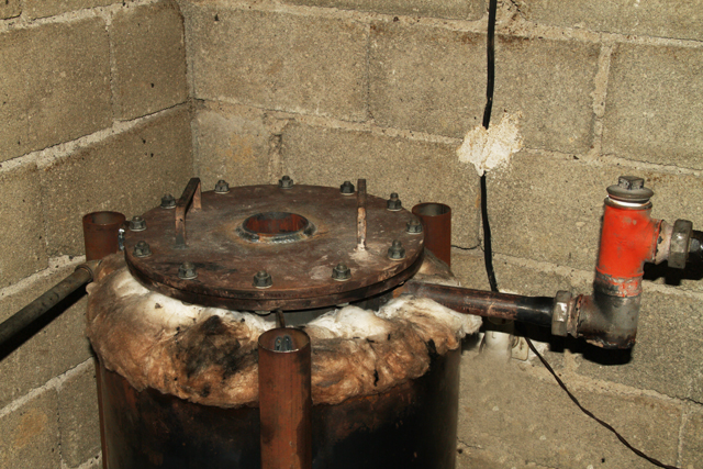

OK, here is my baby
I`m constantly upgrading it, so it changes its outlook every now and then. Description:
Pipe on the left - constant supply of wmo
reboiler - there is a hole in the middle and that is where I keep my heater. Firstly I had it outside as jetijs but then I found it for much better solution to have it inside the reboiler - it is more energy efficient. This way you can use only 2KW heating element for the thing to operate. I always build my own heating el.
The red thing on the right is a swirl tube/reflux. Plumbing guys out there will easily recognize the elements it`s built of. After 12 hr of operation this part gets nearly blocked by soot.

Your reactor looks like a serious piece of gear and has obviously done a lot of processing. Im in the process of building my own reactor so I have a couple of questions. What would be a typical temperature at the reflux/swirl pot. Is it only wmo you are using or is it a mix of wmo and molten plastics? Is your reflux pot filled with a baffle material?
Tanks, Kaguar
I have a question : why your output pipe is blocked by soot, means your output syngaz is full of smoke/dust, but you get clear output fuel ?
My firt attempt to use my fuel, after cleaned it with centrifuge, was injector very disturbing : my injectors keep not functionning well, got enormous smoke even returning at commercial diesel
imakebiodiesel,
yes, this particular reactor has been working for me for the last year and a half and I`ve been upgrading it constantly.
I constructed the reflux/swirl for the present reactor operating conditions so it can be kept on 270 C aproximately. I`m in process of upgrading the reactor which means I`ll have to change the reflux unit as well.
I use about 10% of plastic in the feed, the rest is wmo.
The reflux is filled with iron wool at the present. If you or anyone else has better idea I`m open for suggestions.
