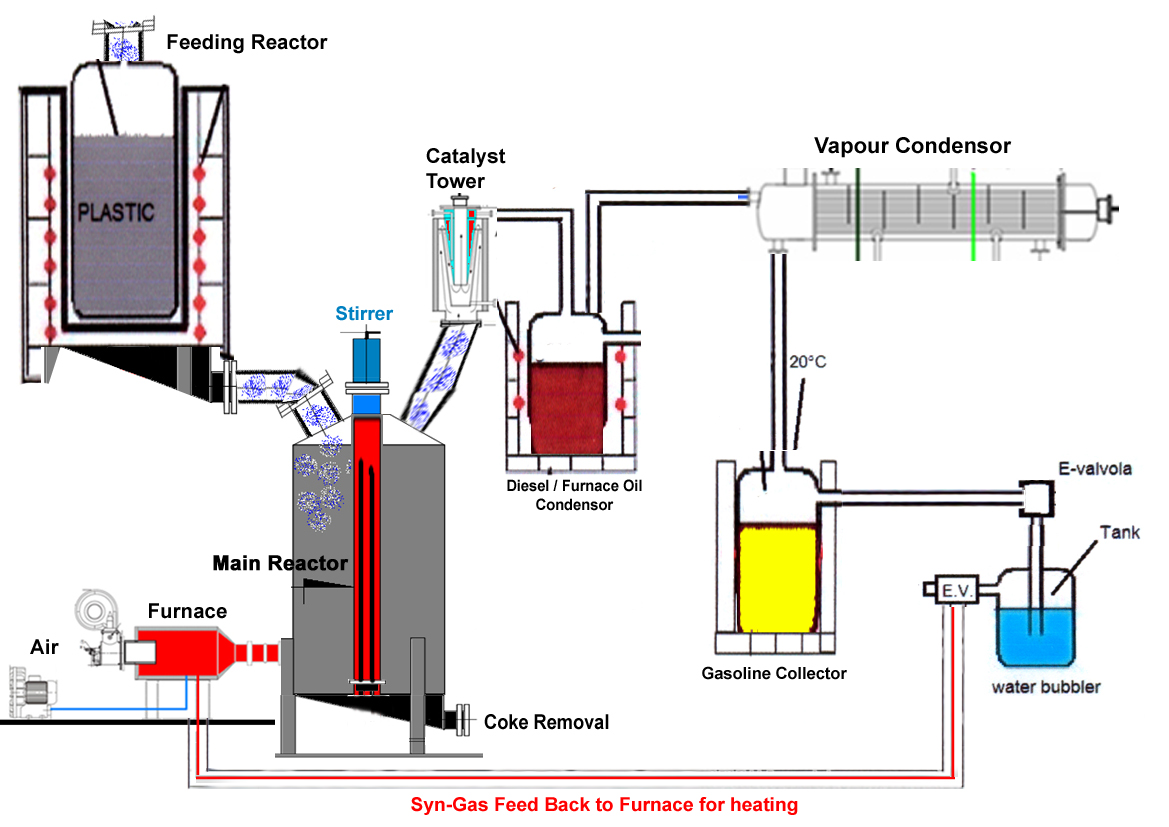

sorry for the image) into the main reactor. This would allow you to skip the heating elements in the initial plastic reactor. In fact it might even (optimistically speaking) allow to skip some of the heating elements in the diesel/kerosene/oil condenser. or at least in your catalyst vessel (asuuming it is heated)
)sensors that are rated to 450oC but I doubt they would work as they require an electric current to be passed /or convected or bounced or something and I do not know if plastic would be able to do this. Perhaps flow sensors that would detect a swirling mass... Any hints?
