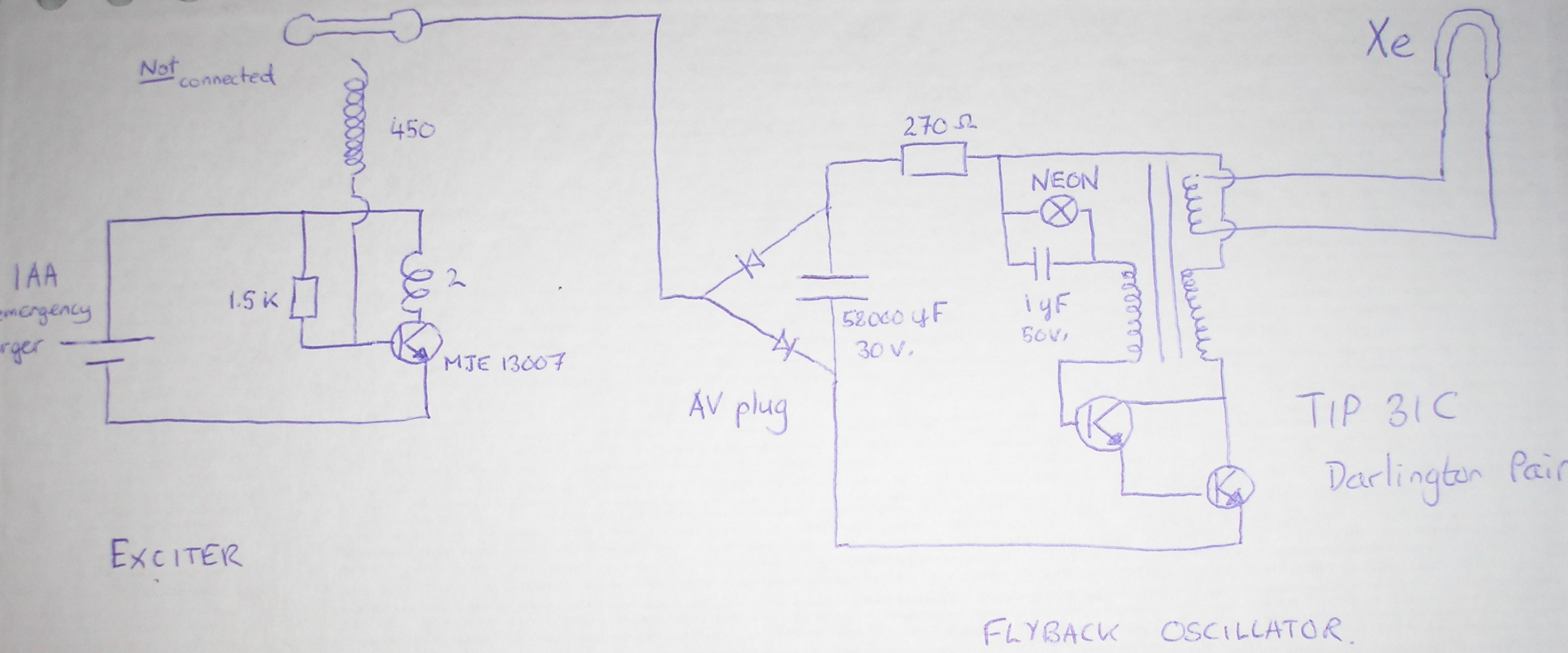

That is interesting. I also have not been able to light a xenon from the exciter with only 1 AA. So somehow you are getting more voltage with your ringer circuit.
I was able to light a xenon with 1 AA (in cell phone charger) using a flyback.
Sooooo----I ordered one of those $4 flyback transformers from ElectronicGoldmine that Xee2 is using and will try that.
