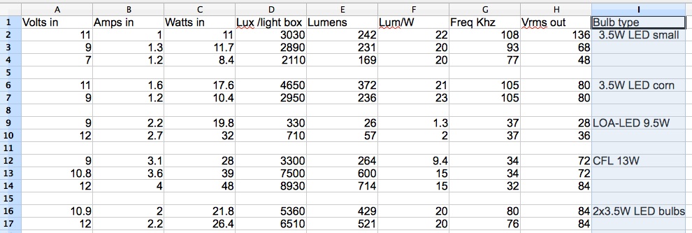

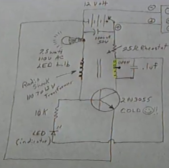

@PB, We meant "does the circuit present in the LED bulb" help with the SJR efficiency ?
We have no doubts that the SJR is working, but we want to know if we could run self-soldered strings of 5mm LEDs instead of expensive LED bulbs.

. Will make more sense when I get final logic out.

. On the light box, ya I'm waiting on the meter still from HK....supposedly mid June I think, Ugh!
