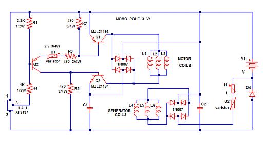

    This is what I am thinking about how to run a three pole Mono Pole motor as a lockridge mptor please let me know what you think. William Reed [IMG]MONO POLE 3 V1[/IMG]

      I hope this works[img]mono Pole 3 V1[/img]

            Hi Rose,
            Where did you get your schematic? I see a couple of problems with it. When you start pulsing the motor coils C1 is going to charge up. As C1 charges up the current through the motor coils will decrease until C1 is charged at which point you will no longer get any current through the motor coils and the motor will stop. What is the purpose of C2? C2 is going to charge up to the voltage of V1 minus the drop across D4. After that C2 is just going to sit there and do nothing except maybe supply a little current during the time of the pulses to the drive coils. My next question is why is D4 in the circuit? The only thing it can do is create a voltage drop in the circuit. You are showing U1 and U2 as varistors. Varistors are temperature dependent resistors. Did you mean to show potentiometers?
            Sorry to be so critical of the circuit you posted. If you can tell me what you are trying to accomplish and how you want to get it done maybe I or someone else can show you how to change your circuit to do what you want. I think I know what you are trying to do but I would rather you tell me so I don't jump to conclusions. I am wanting to get my 3 pole monopole set up as a self runner, but I just haven't had time yet to do that. I believe your circuit with a few modifications could do that. Please don't get discouraged because of my comments. I have over 50 years of experience working with electronics. We all have to start somewhere and keep learning. I still learn some new things every now and then.

                Citfa Thanks for your input. I made the schematic from a lot of the things I have learned here in these forums and past research. I meant to draw U1 and U2 as potentiometers thanks for pointing that out. C1 is in series with the voltage from the motor coils when the field collapses. I was hoping to cause C2 to be charged by this, and to make C1 come back to 0v. D4 is to keep the series voltage and charge from going to the battery and only let it go to C2
