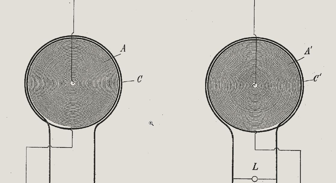

                  Patent US382282 - NIKOLA TESLA - Google Patents

                            • opposite
                              Hi Farmhand,
                              I have a comment on the circuit in your posting http://www.energeticforum.com/188095-post4025.html
                              I am using this thread, as I don't want to interfere with the discussion in the other.
                              ...and the transformers I used were identical CCW.
                              Yet, if you look at the drawing in ALL Tesla's (wireless) transmitter and magnify transmitter patent(s) - starting from "645,576 - System of Transmission of Electrical Energy" - you will see, that the input transformer's primary and secondary are wound opposite to the output transformers winding.
                              I just noticed that (while thinking about directionality in general), and wanted to mention it.
                              The attached image is of patent 649,621 - Apparatus for Transmission of Electrical Energy.
                              And no, nothing of the winding direction is in the text, only in the drawings.
                              • Hi marxist, Yes the patent I think you refer to is this one.
                                Patent US649621 - NIKOLA TESLA - Google Patents
                                I don't know of any other patents where it appears the transformers are
                                wound oppositely.
                                However looks can be deceiving, they are flat spiral coils, so they cannot be
                                wound oppositely. If you take two flat spiral coils "oppositely" wound, and
                                then flip one over they are then wound the same. Or if you take them from
                                the horizontal plane and then place them into the vertical plane as I think as
                                Tesla shows his was used they would be the same. It's not really two
                                dimentional but it has no "turn height". The circumference is constantly
                                diminishing too but that's another matter. Actually it's turn height is in the
                                same plane as the diameter. A solenoid is different.
                                That patent above is for atmospheric transmission as well, I think it requires at least
                                a line of sight between the air terminals. Whereas the ground transmission
                                system does not require that, as in the patents below. The coils I used are
                                modeled very loosely on the first patent below.
                                Patent US1119732 - ELECTRICAL ENERGY - Google Patents
                                Patent US787412 - NIKOLA TESLA - Google Patents
                                Anyway the effect of opposite winding the transformers I think is minimal and
                                only when used close together. The effect is only that opposite wound coils when
                                next to each other rather than being opposite polarity they are the same.
                                Which is why opposite wound coils might work better when they are close
                                together, when they are apart it doesn't matter.
