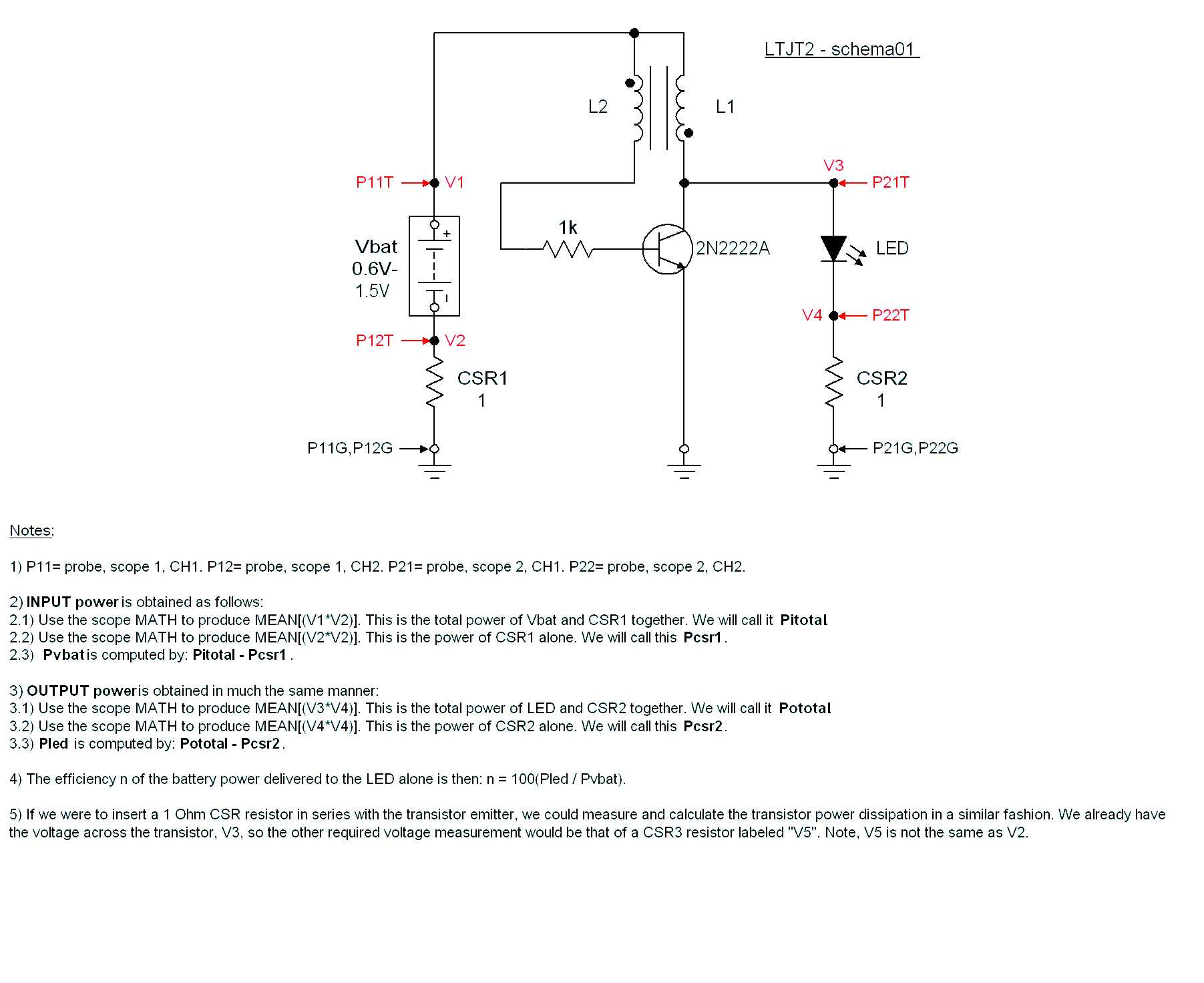

I've been watching the OUResearch forum and an "interesting" development occurred last week when PhysicsProf announced that with a simple JT circuit, nothing fancy really, he had obtained a COP of 1.3, that is, 130%. Over there, they refer to it as "n".
PhysicsProf challenged .99 to try the same circuit, using a ferrite core in a toroid, and guess what -- .99 with his very similar circuit found n = 112%.
.99 wrote about an hour ago:
He gives the schematic there -- replications, anyone? I'm doing it!
Follow the main thread on this (there are two, one for air core which is not as high and one for the ferrite core), here:
LTJT - poynt99 Tests #2
I think there is still some confusion about whether to SUBTRACT or to add the power dissipated in the 1 ohm "measuring resistor". I think physicsprof is right (subtract), but even if one should add as .99 is NOW saying, n = 99.5% ...
Check it out!

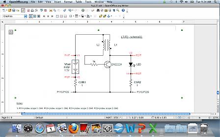

PhysicsProf: OK, so I did with my own circuit what I'm asking .99 to do.
I disconnected the "LT" part of the LTJT circuit, so just looking at the JT circuit. See attached photo of the set-up.
Connections across the "input" CSR we've been discussing (CSR1) and across the battery. The green waveform on the DSO is the total power input (Vbatt * I-csr1).
Next:
Red LED from the collector then across a 1-ohm measuring resistor (call it CSRb). Result is shown in the second photo.
It's a bit rough to calculate the energy into the circuit and the energy out to the LED-CSRb -- my DSO does not give the MEAN for the math function. I calculate energy as explained previously, taking the area under the green Power waveform, for one cycle. I hope .99 will do the measurement the other way this weekend... I may try to go to the University and use the Tek 3032 also...
Long story short, I gotta run! but I find that the NET input power to the circuit is a little less than the output into the LED-CSRb ...
I probably made some mistake. n is about 1.3
The test results for my LTJT with a core and no secondary circuit (normal JT) are as follows:
Pintotal = 29.05mW
Pcsr1 = 1.72mW
Pvbat = 27.33mW
Pototal = 31.3mW
Pcsr2 = 0.66mW
Pled = 30.64mW
n(vbat to led) = 30.64/27.33 = 112%
So either I have a measurement anomaly, or..... Grin
