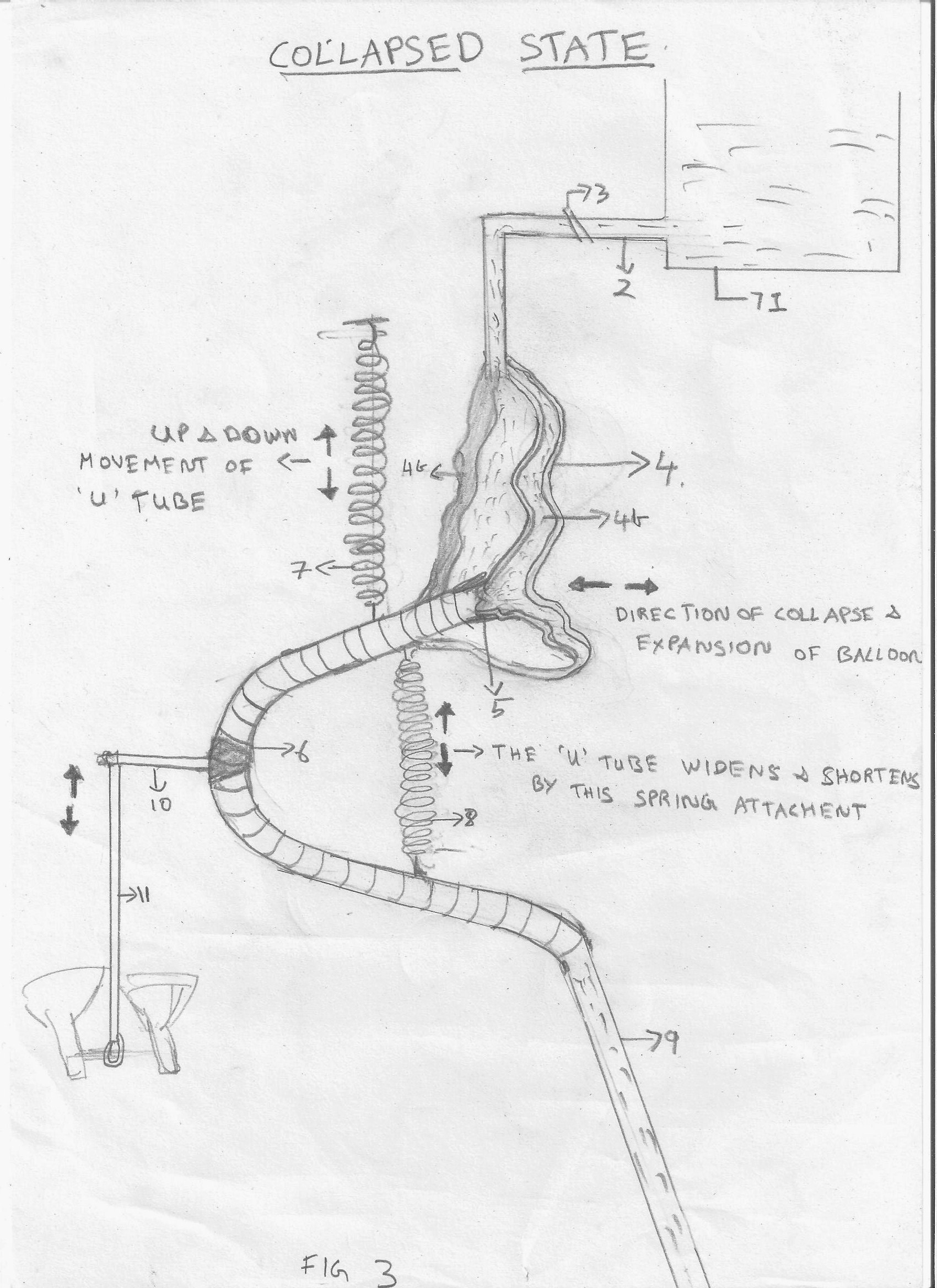

      I really appreciate your encouraging comments. I started of initially to develop a easily reproducible model of heart to understand some aspects of hemodynamics in my small lab. Since I discovered these automatic pulsations of very small setup using birthday party balloons and garden hose pipe; for 4 years I was playing with them like some personal toy only without knowing what else it can be useful for.
      One day I visited a science meusem and I was so engrossed in mechanics department and when I was travelling late night alone in a bus, suddenly a brainwave struck me and thought may be we can use it as a hydroelectric power generating model.
      Another 5 years of my spare time I had spend to design a suitable mechanical model for motion transformation and all my initial models had pendulum tied to the 'U' shaped tube swinging two and fro as the tube swings forward much more prominently then in vertical direction. But they failed to produce sustained and useful moving mechanism for energy conversion.

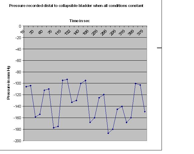

      When I decided to do some measurements I recorded very widely fluctuating pressures in the 'U' shaped tube changes occurring in short span of milliseconds and then I resaoned out it must be repeated water hammers occurring inside the tube which was powering the oscillations, while all the time I was thinking that the collapsing bladder imparts force to those oscillations.
      Further research on fluid transients in bend tubes with elastic supports lead me to design the present simpler version wherein the tube is coupled to a spring with correct spring constant and then I could get sustainable, predictable and stable energy conversion.
      I think these are whole set of new oscillators similar to Veljko Milkovic oscillator where gravitational oscillations are combined with elastic ones.

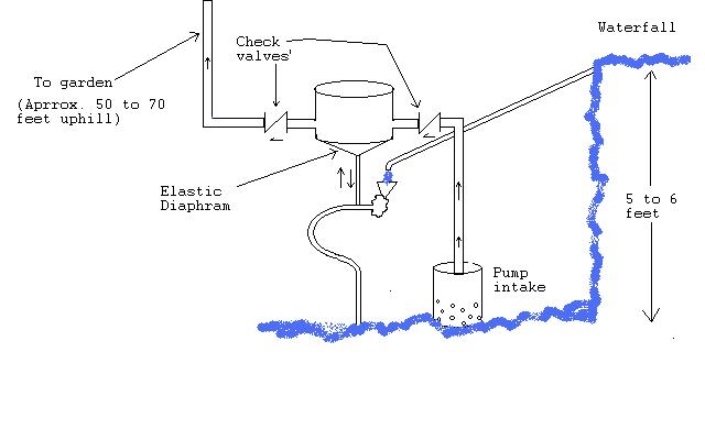

            • #21
              Irrigation pump
              @woopy,
              I see you liked this too. Attached below is a quick drawing i did to show my next experiment. The diaphram pump body will be 4" or 6" steel pipe sealed on one end with metal plate and the other with a peice of tire innertube( as diaphram). A rod will connect to the u shape badder to the center of the elestic diaphram and the oscillation will hopefully run the pump. I will be using two 3/4 swing-checkvalves( that is what I have on hand). On the outlet side I am going to start with small tubing(cost), and see how high I can pump uphill. It may take me a couple of weeks to get this going, because I am super busy right now. If any one else wants to give it a try, please post a video of your progress.
              Also, I noticed on on woopy's video, I noticed that he had the balloon hooked directly to the water tap. I experimented around and it also works quite well with on open gravity feed( funnel).

                              The pressure not only at the output but the entire tubing is negative and it fluctuates most widely in sub-atmospheric range at outlet of collapsing bladder. I will show you the pressure tracings which I recorded.
                              In fact the collapsing bladder acts like a 'Starling Resistor" but in "Starling Resistor" there must be external compressing force, here the normal atmospheric pressure is the compressing force as the pressure inside is sub atmospheric...
                              Uday
