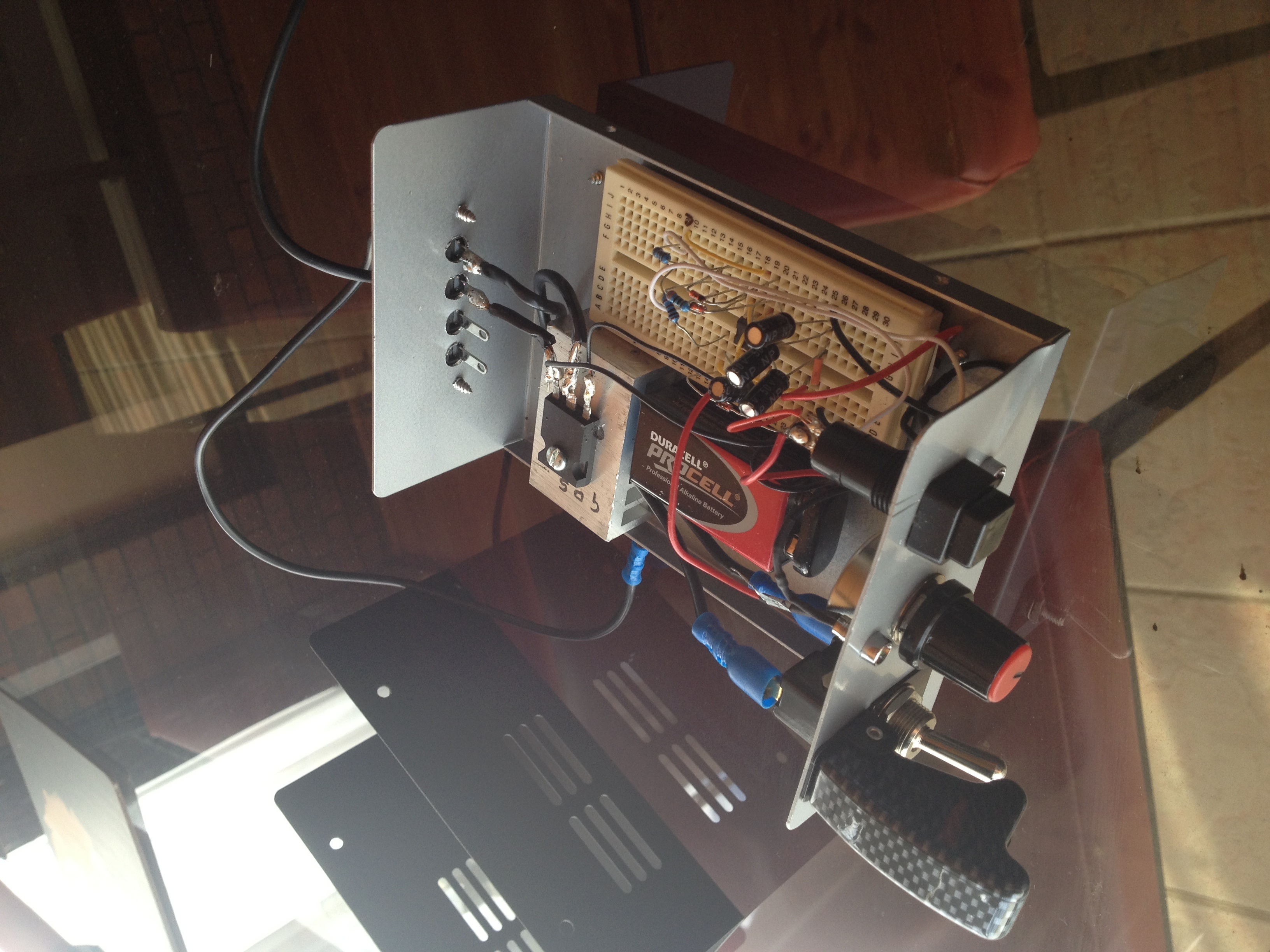

                        Hi Aaran,
                        I have built a signal generator identical to yours. I even used a launch switch like your one.
                        I wanted to ask you about some of the parts.
                        - What type of ignition coil would you recommend ? Would a 24v coil have any benefits ?
                        - What type of CDI to use
                        - What size cap to use for firing would I use
                        - what type of spark plug to use
                        - Is using an optocoupler in the bench timer necessary ?
                        I'm almost there, I have a 4 stroke honda engine from an old pressure washer to test on. Any advise would be awesome.
                        Thanks man
                        • This is the bench timer I built

                            Originally posted by spiderkells View Post
                            Hi Aaran,
                            Thanks man
                            Saw your pic - looks just like mine! lol
                            A normal 12v ignition coil is fine. You don't need a high performance one.
                            Depending on the coil's polarity - that tells you which way to place the diode.
                            I used a Street Fire MSD (MSD's budget model) - works fine. The cap is between 2~4 uf... just use small ones - that is all you need.
                            Any non resistor plug is fine. You may see a couple hundred ohms which is still a lot but much better than 5k+.
                            You mean an opto timing switch for ignition? If so, then no, you don't need the timer. The timer is for bench testing and I use one on my jet engine since there is no timing. Normally, you can shut off the ignitor on a jet after it is hot enough, but I leave the plasma blasting nonstop.
