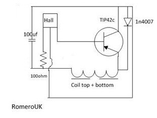

In some of the 'acceleration under load' videos Romero showed this attached circuit to be responsible for the speedup effect.
I did a simulation of that replacing Hall sensor with a zener diode.
The result is blinking led with power disipation shown on the right graph and on the left we've got power taken from the rotor...
Generator Coil Speedup Circuit Simulation
kEhYo77--Are you implying from the circuit simulator that you can get approximately 20x more power out at the LED than the driving AC source??? And that you can do this with a solid state circuit? Have you tried building this circuit? Or am I misunderstanding something...
