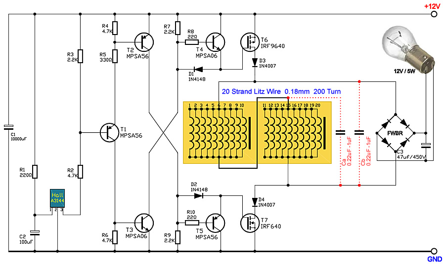

I use the attached picture of the driver circuit,
Respectively on the drive coil parallel capacitor Ca and Cb. Change the value respectively: 0.22uF, 0.33uF, 0.47uF, 0.68uF, 1uF.
No-load speed respectively: 700rpm, 800rpm, 900rpm, 1000rpm, 1100rpm, 1200rpm, 1300rpm, 1400rpm, 1500rpm, 1600rpm, 1700rpm, 1800rpm, 1900rpm, 2000rpm. Try to find the resonance, But: as long as the load is connected, In any case not be able to get the rotor acceleration.
Where I really did not do right?
