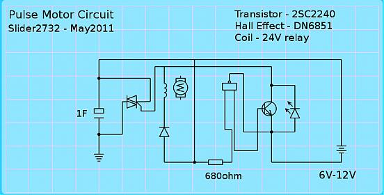

    So, I present the circuit diagram that was made with an online drawing prog, found here: Online free circuit design iENK Electronic Trade Factory
    Please do forgive errors of etiquette, i'm a hands on type, rather than illustrator mathematically or with software.

    I've tried to present the circuit diagram as it is seen within the second video.

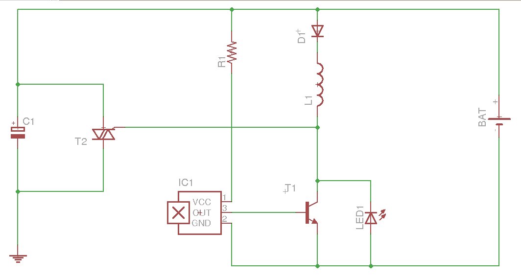

                Slider,
                I have redrawn your schematic the way it made sense to me, so you may confirm or use it to do corrections. By the way, a better program for schematics and is free (for non-commercial purposes) is Eagle from CadSoft. It has all the symbols you need and you can use it for PCB design too.
                I found one or two unorthodox things which I prefer not to comment (it might be the magic you search to explain). There are few things though with I hardly can make sense:
                1. The "Ground" symbol at the negative terminal of polarised Cap (C1) is the Earth Ground? is the minus of battery?
                2. Why would you want to discharge the polarised cap with the triac? If the "Ground" is connected to battery minus, then you put a short on battery too.
                Could you please clarify? You may alter my attached picture if you feel it helps you.
                Regards.
                  Thanks Neight...(i've emailed Neight btw with some info, wasn't ignoring the fella)
                  Thanks for the schematic barbosi
                  As you may well have summised, I ran out of room to link the cap back to the negative of the power supply...but that's what it is.
                  The circuit looks correct, but the cap is feeding into the power input connections, which I hope clarifies.
                  Is Eagle PC software ? I'm running Lubuntu Linux here, cos my PC is from 2002
                  In truth - forget the cap and put a 6V or 12V lead acid battery on the circuit in its place. You'll see why, when independent testing with metered readings has been performed

                    1. I am not sure about the earth ground symbol, however I would guess that it means "connect to the battery negative" in this case.
                    2. I believe Slider used the triac symbol to represent the two diodes being used in a bridge rectifier with only one AC leg connected. This should act just like an Avramenko plug, and I attached a modified copy of your schematic to show what I think Slider wanted to show.
                    Please correct me if this is wrong.

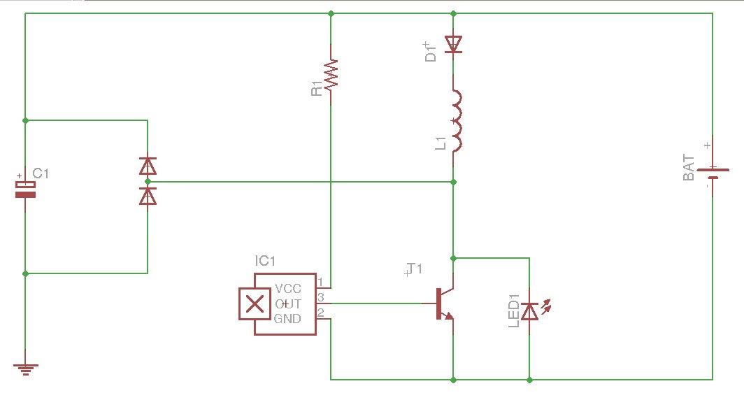

                        Thanks for the correction to the schematic downunder and sorry again barbosi...it was what seemed to fit, from the circuit symbols on that online circuit designer
                        It is indeed a 'happen chance' AV plug, that started as a FWBR, til the circuit ran better with only 1 wire connected from the coil
                        Well, we have it straightened out !

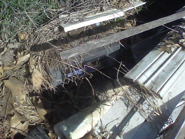

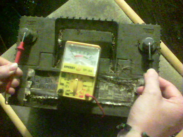

                          Here's the car battery.
                          First pic, as it was in situ abandoned.
                          Second pic, my wife showing the 1V it had left on it.
                          What do you reckon, ever seen a better candidate for rejuvenation ? lol
