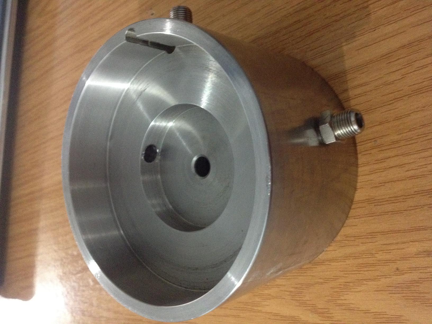

              • #22
                Originally posted by burtonenergygroup View Post
                Very cool, how does it seems to be working so far?
                So far its working as it should I will post a vid of it working very soon. Here is a picture of one of the two rotors before I put it all togther.
                • #23
                  LeanMixture
                  Thank you for sharing you work.
                  most intriguing!
                  Chet
                  Thanks. I removed one of the two rotor to take a photo of the housing on the side that circulate the steam.
