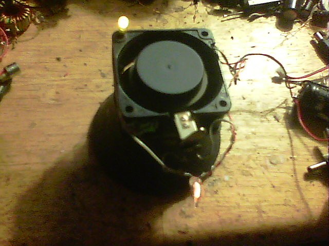

    Some of you guys may well see this device and notice that many elements of today's experimental methods are incorporated within it - that is the idea.
    It's a high voltage generator, from a 6V, low current power supply.
    The name is derived from 'fan' and 'generator'. I believe 'fangen' is a slang term for awesome, cool, great and that it means collect or catch in German.
    After reading up on and viewing YouTube videos of Ed Leedskalnins' Coral Castle work, I linked that with Imhoteps' Bedini PC fan, my own White Crow pulse motor ideas and many other techniques, that could be implemented quite easily at zero build cost.
    The device meets the intended aim of delivering HV from a small power source and is to go forward with wireless energy experiments, single wire rectifying, magnetic resonance work and much more.

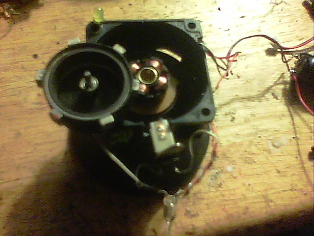

    It's a PC 12V fan, with drive electronics remaining to power it from 6V, with which it revs to a good usable speed due to inertia from the magnets and no fan blades.
    6x neodymium magnets surround the fan rotor and, because the internal weak magnet material has been left in situ, enables the magnets to be attached and moved readily...they just clip to the sides and remain in those places under power spins. Once the correct placements have been ascertained then standard superglue will hold them in place.
    There is a 24V relay inserted into one side of the fan casing, this is the fired coil.
    A Hall sensor (DN6851) was taken from another fan and forms a Hall sensor based coil collapser. Collapsing the coil just before a magnet reaches it was part of RomeroUK's work. In this case, a 2SC3200 very standard NPN transistor handles the switching output of the Hall sensor and shorts the coil at the correct moment. Simply holding the sensor to the side of the casing allows finding the best spot...superglue can again be used to hold that position.
    There is a small neodymium magnet at the rear of the coil.
    Operation below and above 6V shows less efficiency. At voltages lower, the circuit runs erratically or not at all. At voltages above, there appears to be no significant extra HV output.
    The magnets are derived from old CD-Rom drives, there being 2x neo's in the laser assemblies.
    Current used by 12V PC fans is typically approximately 130mA at 12V. I would welcome a replication that could show the actual figures of DC power used and AC power output.

    The magnets are arranged NSNSNS. If all face the same direction, they halt the operation of the motor.

    Attached are a couple of pics. One shows it generating HV and the second is of the rotor and magnet placings..

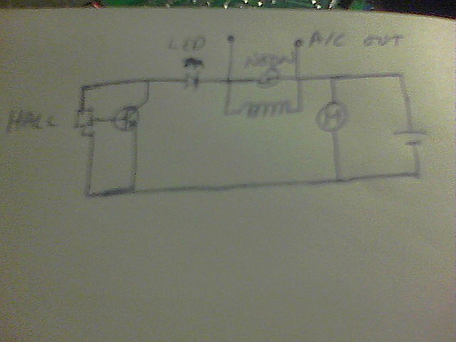

        Can you make a rough drawing or sketch so we can see what is happening ?

          Circuit wise, i'll draw one up certainly. May not have time til this evening, but here's what happens.
          It's based on a standard 12V fan with the blades removed and 6 small neo's fitted to the rotor. Then a 24V relay coil sits within the outer case and a Hall sensor is at its side where the effect of BEMF is greatest. The Hall triggers the base of a 2SC3200 NPN transistor, which sends a negative spike to the coil. The other side of the coil is connected to positive of the supply. You may expect that to be the negative, to short the coil, but i'm finding a bigger neon lighting ability on this one by connection to the positive. An LED lights to show firings from the transistor and also limits the BEMF returning to possibly destroy it. As the Hall next switches, a magnet passes and dumps the energy through the coil, lighting the neon. A couple of small neos sit behind the coil and greatly assist neon lighting.

              Got to get 8 kittens ready for spaying collection and then i'll draw a diagram of the FanGen circuit. I was kindly pointed to a Freeware diagram package but would need several days to learn it.

                Rubbish pic attached, but it shows the simple FanGen circuit
                Running voltage is 6V to 12V. The LED seems fine, doesn't over brighten and the 2SC3200 transistor has now run for a few hours of tests. A 1K resistor was on the positive rail for the DN6851 Hall sensor, but seems unneeded. Similarly, a 100ohm resistor in series with the LED was thought to be limiting needlessly and so now is also omitted.
