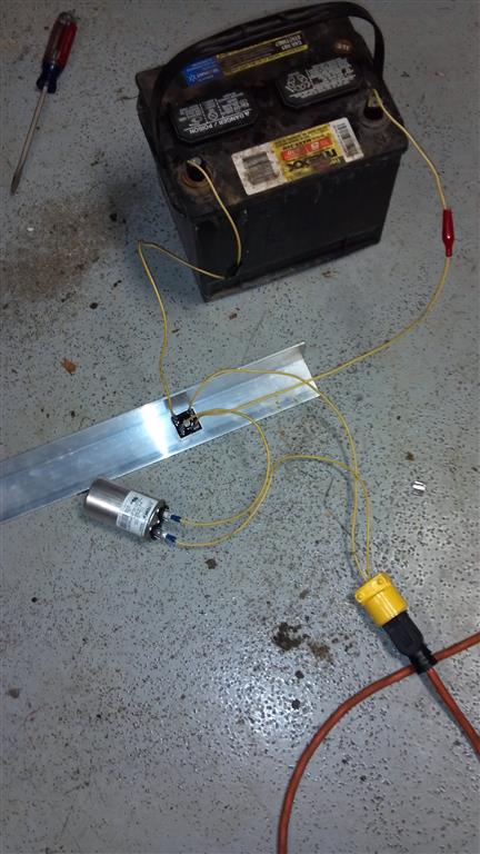

Don't do it!!
Please do not build this circuit! What most people don't seem to realize is that if the 100 uf cap should short out you will then have full line voltage on the bridge. If it is connected to the battery you will blow up the battery! If you were to touch the leads while it is not connected to the battery you will have the about 170 volts DC on those leads even if the cap is good. This is if you are using 120 VAC. With 250 VAC the voltage on those leads will be right around 300 volts DC. That kind of voltage will kill or seriously injure you. I have worked in electronics for over 50 years and I would never use that circuit for anything unless I wanted to kill something. Use a transformer. No matter how worthless you are as a person your life is still probably worth more than the cost of a transformer.
Respectfully,
Carroll
