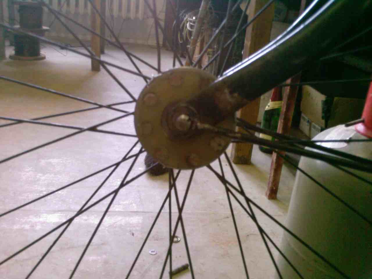

hello all, wonder if someone can help. I am new to DIY magnet/coil generators. Have read some info. on net and made a simple prototype with 8 mags & 8 coils. i placed coils in stator in all the same direction, mags were placed N-S-N-S- etc. Coils were wired in series, ie 1st coil wire in connected to 2nd coil wire in, 2nd coil wire out connected to 3rd coil wire out, 3rd coil wire in connected to 4th coil wire in etc - when spun by hand i had an acceptable 2-3 volts - this was all proof of concept for what i really wanted to do was to build my own bicycle light dynamo - However the only place i could fit it was on the front forks on the hub of the wheel but due to the bike forks i had to leave out 2 coils - see attachment - on my prototype I mimicked this set up and still got a healthy though intermittent 2v..but on my bike set up i got .9 - 1v only, can anyone suggest another wiring set up ? I am using 0.16mm wire and neo mags diameter 10mm 5mm thick.. coils have 26ohm resistance 700 turns, core 10mm wide, coil diameter 17mm, coil leg width 5mm - is my relationship between coilwire and magnets faulty ? .. sorry if this all sounds a bit vague as i said am new to this wonderful phenomenon and truly fascinated .. thanks all ..

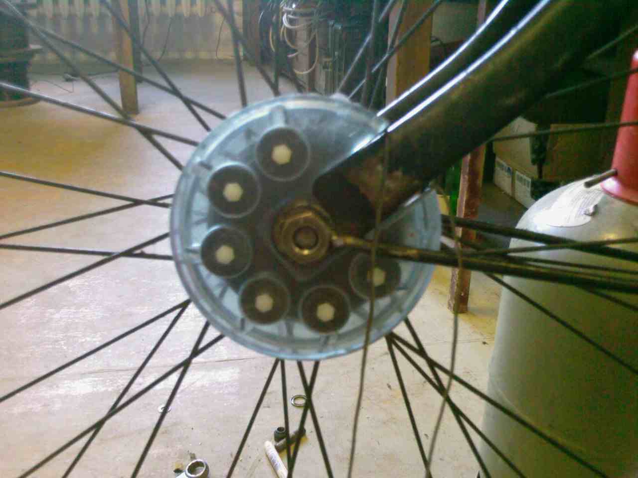

I can see the coils in your pic,
but not the (number of) magnets.
They should be arranged so that an
equal number of alternating magnets
line up with an equal number of coils,
with every other magnet being N.
so as the N-S-N-S... magnetic flux swing goes by each coils pole,
the even numbered coils are wired one way,
and the odd numbered coils are wired opposite.
Hope that made sense to you.

thanks, I de soldered and rearranged the coils but still got the same results ie .9-1.2 volts ? is this possible or have i really misunderstood coil direction. Have attached photo of rotor, there are 8 magnets. I think I may have made my coils too thick and not wide enough. Am going to re wind some more today and see how that works. Making them wider and not so thick, my magnets are 5mm thick so will make coils 5mm thick also, I have also got a lower gauge wire 0.1mm (AWG 38) - Magnets and coils are lined up center to center. No I have not as yet put in a FWBR, but will do once I have got a useful amount of volts, I imagined putting 4 diodes in my system would wipe out any volts i may have ? Will also add a steel core to new coils as someone suggested that this might attract flux better, is this correct ?....Last edited by carloc; 11-04-2011, 12:27 PM.
Possibly, invision the magnetic flux as a water flow to keep things simple when visualizing the flux pathes.Originally posted by carloc View PostIs this possible or have i really misunderstood coil direction.

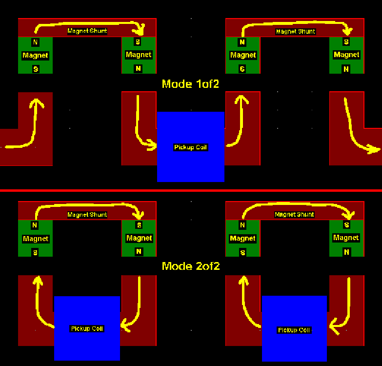

V2.0:
First, cut and place strips of ferrous metal across the backs of magnets,
(the end opposite of the coils) so they are grouped into pairs of magnets.
Next, bend/form four "U" shaped coil forms out of some ferrous rod stock,
so they match center-to-center the distance of an adjacent pair of magnets.
You have now two options here,
you can wind two smaller coils on the short sides of the "U",
or you can wind one long coil on the long bottom of the "U".
Now, if you visualize the flux pathes (as water if it helps...),
you can clearly see a complete loop back to the starting point.
With all eight poles aligned in one postition of the two modes,
the path is through two magnets and one "U" including It's winding(s).
With all eight poles aligned in the next postition of the two modes,
the path is now through all magnets and all U's including all windings
in a successive path around the whole circle involving all pieces.
This will help you to see why one coil core has flux going one way,
and the next one has it going the opposite way, hope this helps.

I tried a test drawing as seen below (Top view of V2.0 idea...),
it just shows what happens as the wheel turns through both modes,
it consists of eight magnets, four magnet shunts, four cores, four coils,
thus eight pole crossing points between rotary and stationary components..
This method allows all four coils to be wired in series or parallel.
without having to reverse every other one as discussed earlier.

-- hmmmm .. I see .. now that is a radical change ...
my magnets at the moment are seated on a steel ring then epoxyed, do you think that could be interfering with flux flow.
I can see that the mag shunt and U coil is a nice set up .. I only have room for 6 coils due to bike fork so that would mean 3 U coils... would that work too ?..
your jpg was very helpful as was your text .. but yes pictures speak better sometimes

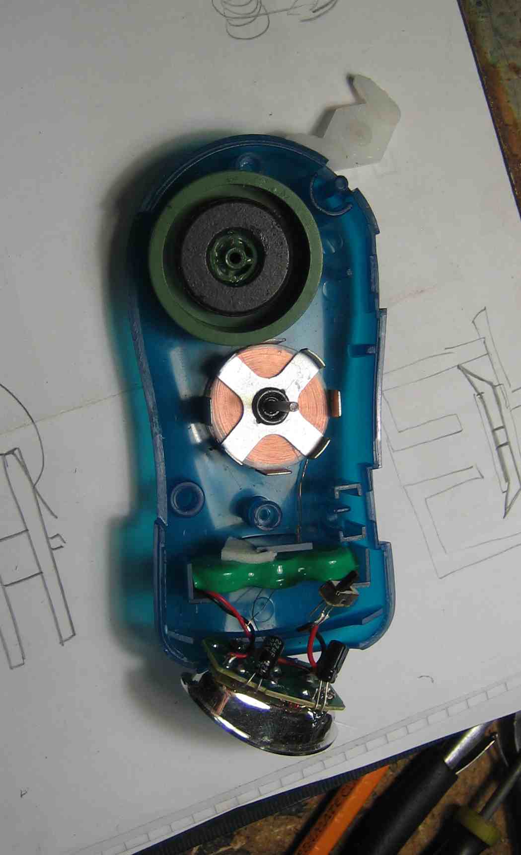

I opened a wind up torch ((flashlight)) we have over here in euroland to see how it was done and it was a simple coil with what seems to be metal strips either side with rotating round magnet over it .. i have attached photo.. do you think i could make a larger version of this ? .. this small version powers 3 white LEDs more than enough for my purposes .. it seems less fiddly to build .. just one coil ...

Sadly, many would jump straight to yes on that one,Originally posted by carloc View Postmy magnets at the moment are seated on a steel ring then epoxyed, do you think that could be interfering with flux flow.
as they are arranged in a N/S/N/S... fashion here.
But I don't see that as a problem,
they often get shipped that way.
Magnets need keepers as example.

It is what you don't see that makes this work.Originally posted by carloc View PostI opened a wind up torch ((flashlight)) we have over here in euroland to see how it was done and it was a simple coil with what seems to be metal strips either side with rotating round magnet over it
Take a small magnet and walk your way around the ring magnet.
This is not a standard axial polarized magnet, like in a speaker.
You will find it has poles embedded in it around the circumference,
by the looks of the choice of components, it appears to be four.
You should observe two places on it 180 apart that attract,
and two places 180 apart that repel, placed 90 from the first two.
Not much advantage to using this idea,
this magnet would be to weak to reuse,
and custom magnets are sorta pricey, sorry.
(They hold a polarization on them as they are cooled)
Just rememeber this tidbit, it applies to the flashlight design,
you can spin a magnet, but the field does not spin with it.
(See homopolar generator stuff on youtube if needed).
So if that magnet gets spun, it has more than one pole.Last edited by WeThePeople_USA; 11-05-2011, 02:30 AM.
