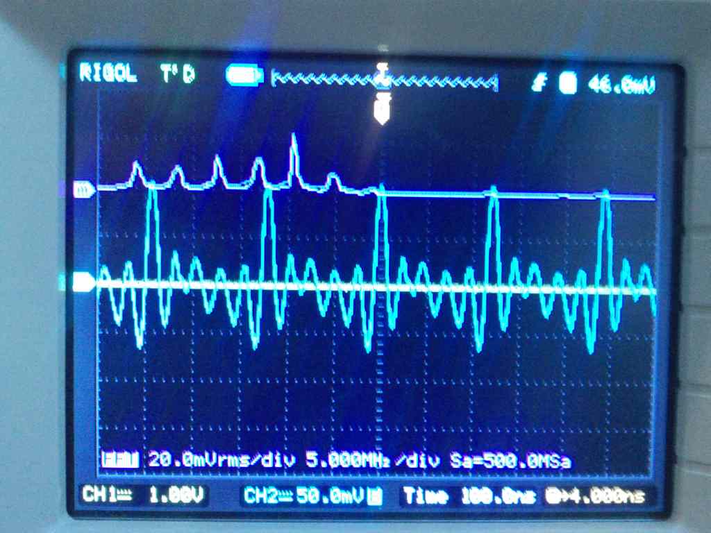

                      I've been playing with this.
                      1) It's interesting that it makes equi-step harmonics... 3.1mhz 6.2, 9.3, 12.4... 4.1, 8.2, 12.3..... It reminds me of the traces that stiffler gets when he gets his circuit in resonance. I thought that harmonics were doubled... 440, 880, 1760... not equi-distant steps.... but anyway...
                      This is a shot of the harmonics when the oscillator is running, the spikes on the purple are about 4mhz apart each time, and it's a linear horizontal scale, not logrithmic.

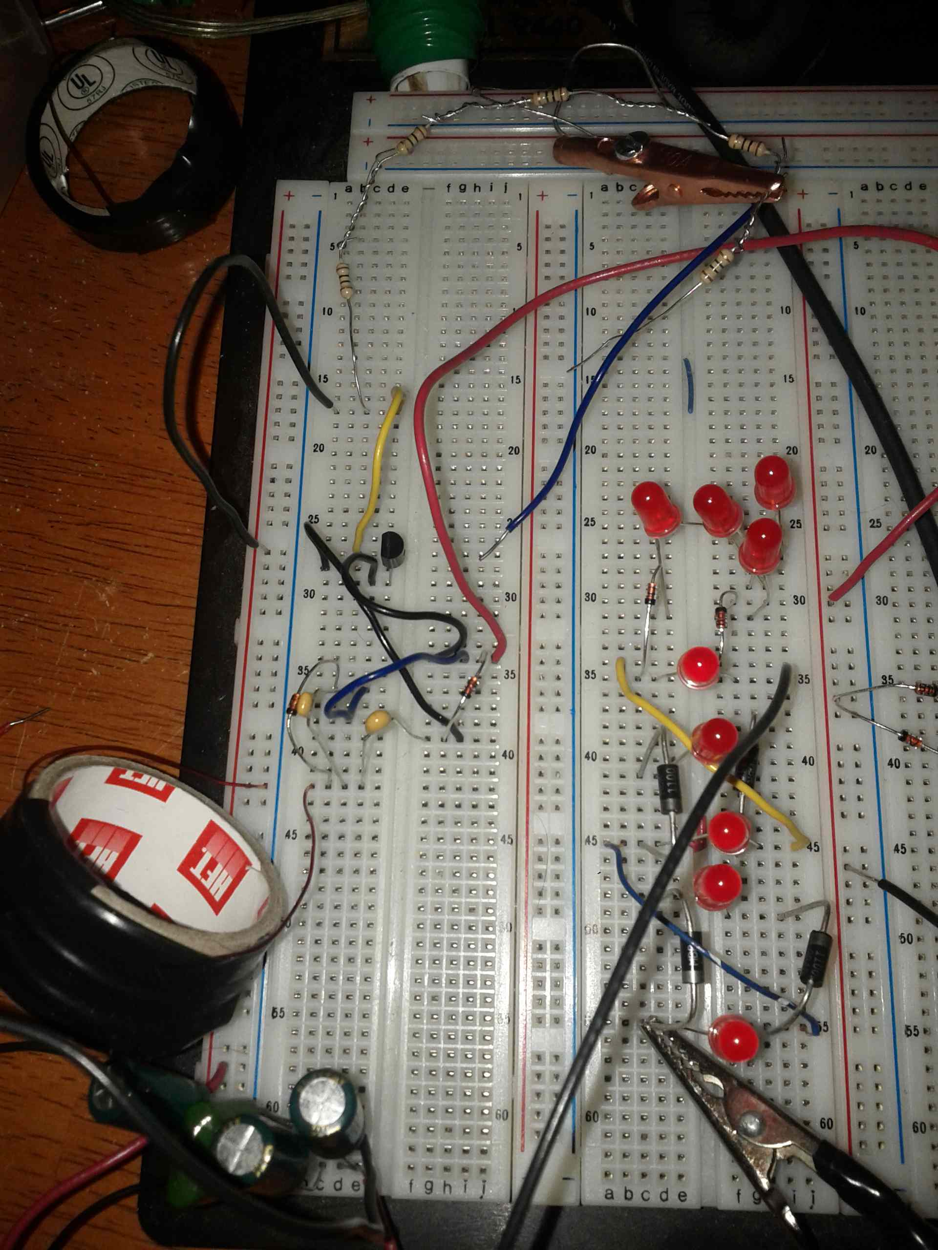

                      I wanted to add some other coils for transfers or other directions, so I tuned a long tall coil (1000 turns 1" diamter 24 gauge magnet wire) until it was about 4.1 mhz, (it alone with nothing is somehting like 6, so going down wasn't too tough)... but even adding a single clip lead to the end increases the capacitance to reduce the frequency 1mhz... so adding a 6 inch with 2 clips is about right to bring it down to 4.... and while I was tuning it, I had it laying near the resonantor board, and the LEDs on the board started lighting. Induced reactoin in the circuit. So I added some caps, triggered it with the battery and switch, and it lasted quite a few seconds before dying. Then I moved some probes, connected in different places trying to get a more acurate measurement of the gyrator frequncy itself, which seems also dependant on the load on the antenna and other things around it. And at times, just having that coil with a different tuning near the circuit keeps it from working altogether... so I move everything away, get back to a starting point, reenergize the circuit and work on resonance...
                      But then I move this or that, and reach past the circuit to turn a knob on the scope, and the whole thing dies.
                      I used tantum capactiors (100pf, and 85uf respectively, as measured with my meter Triplett 9007 3-1/2 Digit DMM with Backlit Display 391-064 ) , I used the same transistor as specified, I used the 1n4148 in the circuit, I've wired it with jumper leads that are (like) 2inches in length to various parts, I ran (like a) 8 inch jumper wire out to a rail that I then ran back to the LEDs. My coils are hand wound on empty electrical tape spools like I said...
                      Maybe because it's where I chose to put the parts, and how far they are apart, the coils are 6+ inches away from each other, as they may interfere too I suppose.
                      I have a higher detail of my layout, and maybe I should make one with circles and arrows that I can put a paragraph under each part.
                      This was a shot where I had used a black wire at the upper left to bypass the 100uf cap and small coil attached to the positive side... the coil would go from + to 18 and the cap from 18 back to negative, in about the same length as the black wire is. The yllow wire goes to the collector, the chain of resistors laying across the board is unplugged at that point, but goes into the base of the resistor to start it. The left black wire goes from the base to the n4140 diode to the right (39), and a 85uf cap from 39 to 42. The other n4148 and 100pf cap are connected from 42 to 36, which is then connected with a blue wire to a black wire that goes to the emitter of the transitor, and the red wire that is the signal output. The caps at the bottom left are optional, and can be connected in parallel with the battery, they're only a few microfarads (10's of, maybe 100?)... they will keep an LED lit for a while . THe next rail from the top down is my chain of LEDs.... I ran the signal scross those into the + rail, where I then tap with a black wire about (46) and go back into the LED chain at (34). The bottom alligator clip goes to virtual ground (it's just hanging, or clipped to aluminum plate... if attached to real ground, makes evrey other LED on the chain light up (very strong pull in one direction). Notice on my LED chain I've used some 1N4001's and some 1n4148's. These are fairly low power LEDs and two double AA batteries light them up pretty good. They have a voltage drop of like 1.7V. The Yellow wire in the chain of LEDs is from the first block to the second block, then the blue/white wire is from the second block to the third. I've disconnected LED blocks and reconnected them, they don't seem to have a lot of impact on making the circuit work, and are a rather resilliant load (that is attaching and deteching them doesn't usually kill the oscillation). The Two 1n4148's in the middle going to the right don't connect to anything, they were a test point, the beginning of a DC conversion point, where I was putting capacitors, which I was then going to feed back to the power rail, but they are open (they are extra, and should be of no consequence). There is a coil sitting on the board at the top, but that should be of no consequence also. Off to the very bottom left is red and black wires that go to + and - battery connections and +/- rails appropriately.
                      The smaller coil and cap across power don't change the circuit character as much as the larger coil.
                      I've bypassd the bottom LC ringing circuit and got a single 20mhz signal out of just the transistor (the subharmoics disappeared). But that didn't work to light LEDs...

                        hi d3x0r,
                        I suppose you are not the author of this quantum girator circuit, and you are one of the tinkerers like us, right?
                        I wonder if you can check if MPS06 and 2N2222A can do the job as BC547B, since I reviewed the spec sheet of BC547B, and apart from its hFE which is almost 100MHz, its no big deal as a transistor. As I told Somertje to go to the thread of Dr. Stiffler and check out the SEC18-X circuit tuning procedure, the tuning of the Doc's circuit is very difficult as hell.
                        The Girator circuit seems to be a lot easier to tune, and provide much more power to light leds. The modified diode plug presented in the Girator circuit seems to be un-balanced comparing to a standard av plug.
                        Your switching of the 4.7MOhm resistor after starting the circuit seems to be ingenous to me. And also the bypassing ground connection of the 4.7uH inductor to reduce supply voltage to 9V does seem original.
                        Please share with us your insight about this circuit with respect to Dr. Stiffler's SEC experiments, as both apparently tackles the same field and both apparently receive a response from the excited lattice.

                          Yes a 2n2222 works and generates the same frequency, also a mpsa06 works, but I had to put it in backwards(?), the one I used has the same case style as the BC547B (black with a flat side), but I had to put the flat spot the opposite direction, otherwise it just sat there and got hot.
                          Both generated apparently the same harmonics in the signal.
