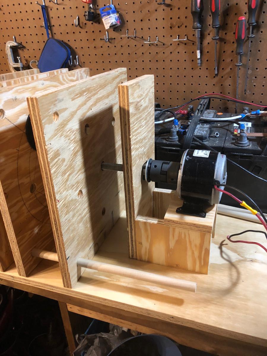

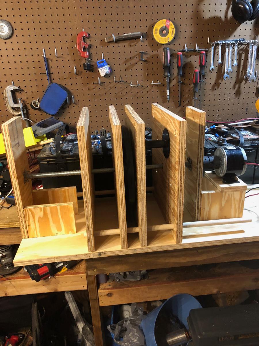

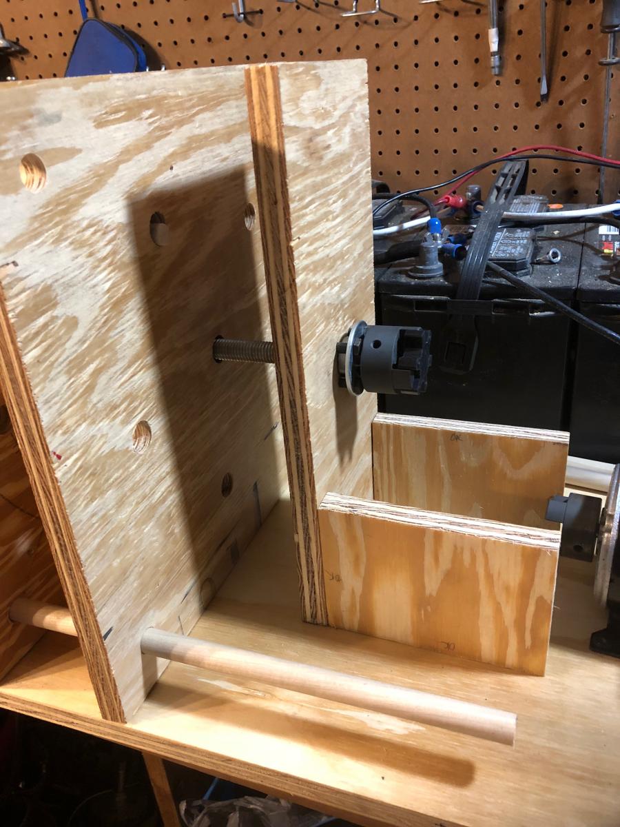

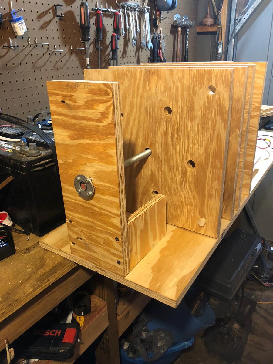

                I did manage to do a little planning and building on the generator yesterday. With the parts and pieces coming together now the mechanical side is easier to see. The bearings and holders are very important. The end pieces will hold the bearings which hold up the axle and rotor. Therefore both must be aligned and sturdy built.
                My apologies for inadequate explanations with video's or more pictures.
                Coffee is needing a nuke warming,
                wantomake
                It's good to be back !!!!!!
                • Another rainy day
                  Hey forgot to mention good coffee too.
                  Yesterday was able to get a little more work done on the upright generator. working with wood is real pain, but trying to get a decent alignment is possible just takes more time. I would recommend using the hard plastic Dave Turion uses in his video. That will be my next build hopefully.
                  Of the (4) vertical 14" x 14" pieces only the outside two move out to insert coils as they are needed to be rewound for testing and such. PVC pipe will be cut and placed in between each vertical board on the dowels as spacers to hold each one the correct distance apart. All parts are non-metallic to avoid interference with the rotor magnets. Even brass or aluminum screws can get eddy currents in them. (From what I read)
                  Well I did spin it up with the modified Matt motor there and it had no vibrations to worry about. Cause the threaded rod I wasn't sure would balance good or not. When the rpm increases it may do an Irish jig across the bench? No, I'm not Irish. Therefore I'm hoping to get the coils correct winding and core material to avoid heating and keep the rpm low. This my coffee drinking friends will be the greatest challenge of ALL. But one hill at a time.
                  Hope these pics help. All teaching and positive comments are welcome,
                  wantomake
