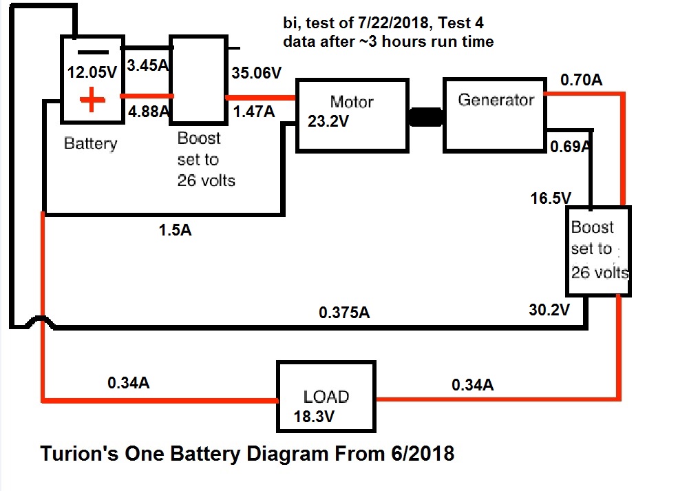

      • Test 4
        Here are data from most recent test.
        Wattmeter on battery:
        12.05V, 3.4A, 40.97W, 9.09Ah, 111.21Wh
        Wattmeter on 50Ω load resistor:
        18.31V, 0.33A, 6.1W, 0.885Ah, 15.3Wh
        • All the conversions add to the total losses... It appears that the biggest problem is the motor/generator in this scenario. Just a quick calculation showing around 25% efficiency over all with an even lower % return to the battery.
          Simply using an inverter with a 24volt transformer rectified through a load back to the battery would yield a higher return. Assuming 90% efficiency of both inverter/charger yielding 80% overall you could return 36 watts with a 45 watt input ( not including the energy dissipated by the load ).
          If there were some cheap "isolated" boost converters, that might be the only unit needed to achieve a 90% return. At that point it would seem logical to utilize a system that would use the input energy to the converter more than once bringing you closer to unity.
          So what would it take to drive your load while charging a capacitor and return a small portion to the battery, then using the energy from the capacitor to drive the load while the battery is being charged? You need to either find a source of energy to add to the system or make better use of the energy you have available... yes? no?

                                I duplicated your experiment with equipment I used for the previous tests. Battery was at 12.66V, current was 1.02A on both + & - terminals of battery. Boost converter output was 35.0V. Motor was at 22.3V. Motor current was 0.456A measured at both motor terminals. I measured 1.3A into converter input positive and 0.87A out of converter input negative.
                                I looked over your vids a bunch. I suspect the accuracy of the current reading. Really seems like a lot of power (~48W) to run the motor at no-load. Also, it looks like a yellow test lead clip on the battery negative terminal. Is that just to secure the test probes or does it connect somewhere? Wouldn't happen to have a good old analog ammeter to check that battery current?
