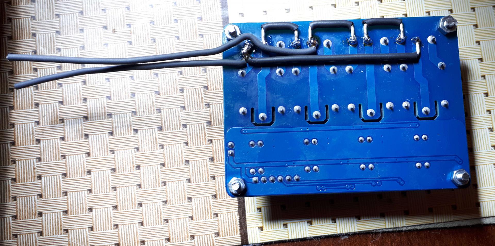

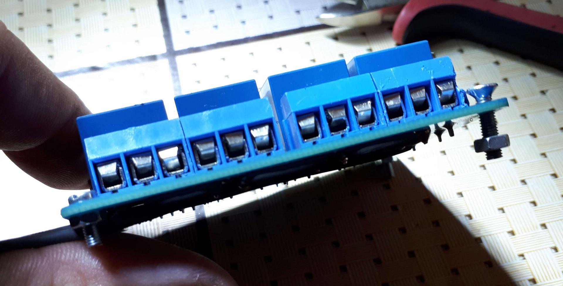

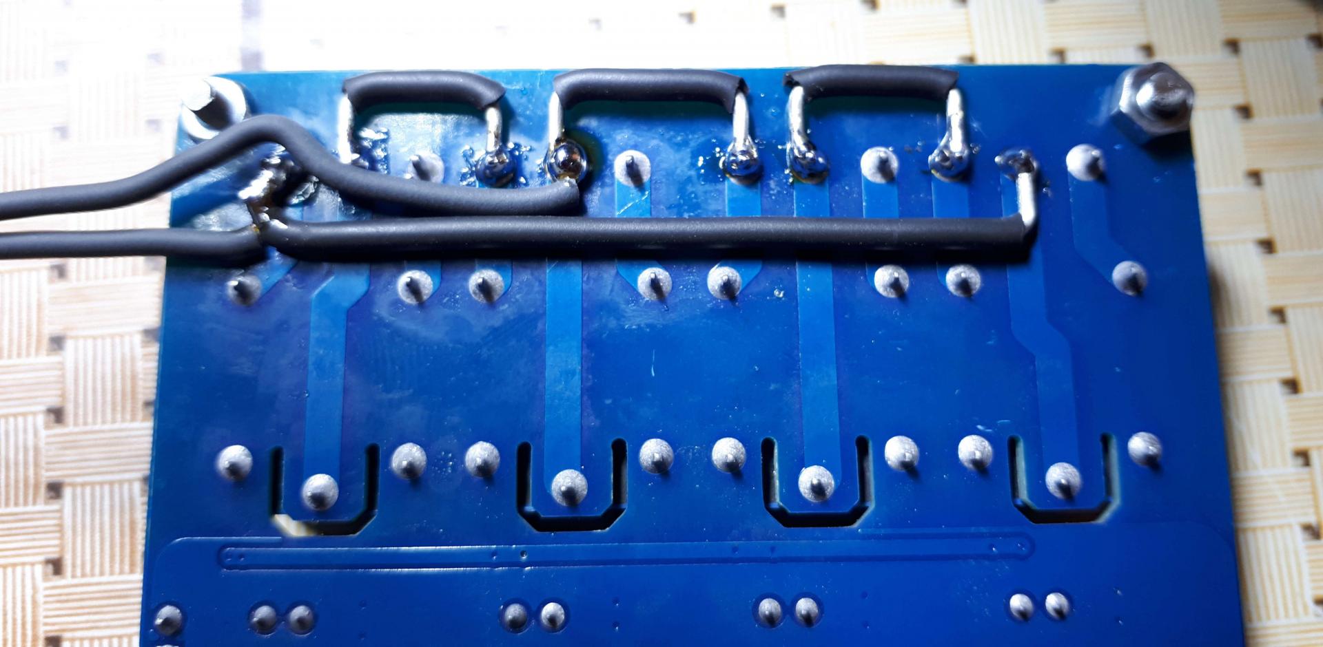

@All,
Just another quick update on my Battery swapper project, HERE
The wiring & all setup was simplified, a relay initialization bug was solved (all relays was ON at Arduino Boot for about 2 sec!), and a simple stopwatch is showing on the OLED display time passed, for comparing working cycles.
Now it's time to focus on conditional voltage loops...
Best regards.
P.S. Now the link should work
