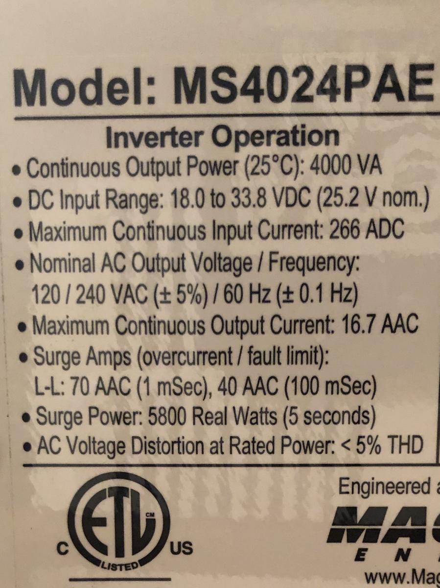

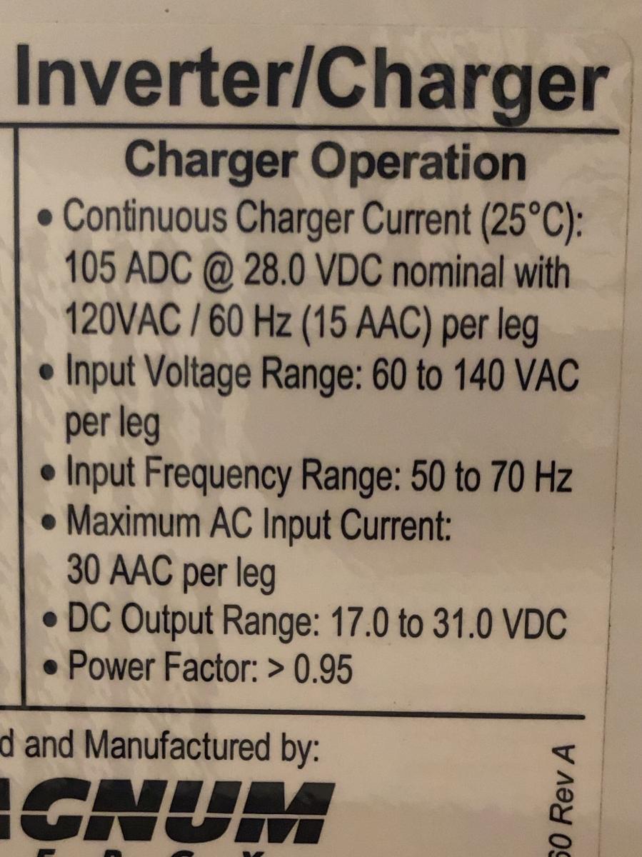

                    • Pothead, What do you mean by "4 inverters 30/30 apiece". I've got a big inverter (and other small ones ) but can't decipher what 30/30 apiece is about.
                      • Sorry
                        Hello ewizard, sorry about the confusion.
