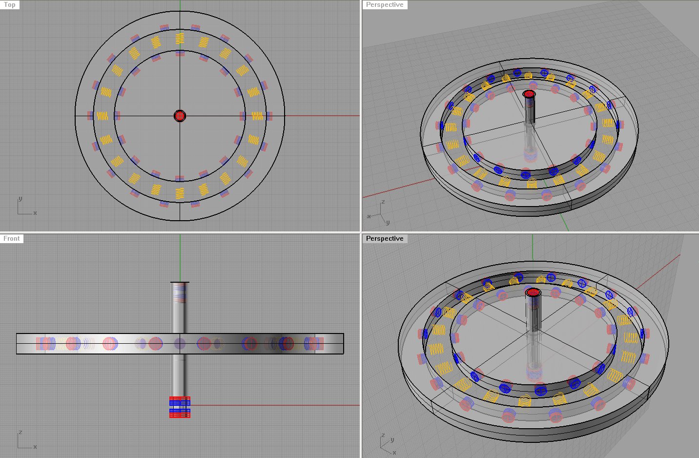

Now for the horizontal forces it could be interesting to combine the generator and the magnet bearing. Not sure if that is possible here is a concept:
Inner ring attached to VAWT, VAWT rests on disc. The magnets from inner ring and outer ring repel so, no friction and nothing touches.
The inner ring rotates, and the coils are stationary.
But now put coils in between, and you have a generating friction-less bearing.
It might be even possible to spin the outer ring mechanical as well... More power! ;-)Last edited by Cherryman; 03-17-2012, 04:25 PM.
