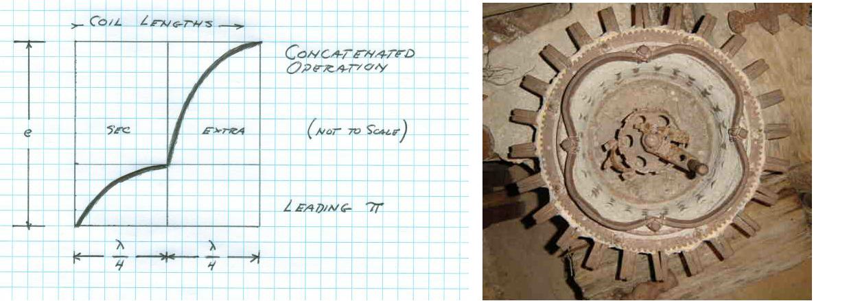

            David, I hope you enjoyed the maths, I was overhwhelmed that subtracting pi from your pri:sec coil ratio rendered 1.54. to 2dp.
            I am now studying Eric's concatenated set-up in comparison to the tandem set-up. I am working on a magneto flywheel with probably about 7 coils around it. As I said more useful things next time, but I can't emphasise enough how the gifted people on this thread could spend some of their time on the chemical understanding to how these things might be derived, from the chemical battery upwards. Please do it. Also look over the math I posted, I am no mathematician but at the very least I have discovered something compelling which would go a way to expressing the ratio of transverse waves to longitudinal waves, as a scientific and TOTALLY UNDEBATABLE PROOF base on the ratio's of surface area between the coil's and the magnification, I do believe we could formalise a design that merely shown the billions of ignorant physicists and engineers alike who do not "believe" in the Longitudinal.
            Indeed if you can show the ratio made manifest, in either tandem or concatenated coils I am going to be very grateful, as will the world when they finally figure out how important it is going to be -

            • Multiply Math
              David/Smokey, I don't know about anyone else but I'm always confused by your posts. Would it be possible to give INDIVIDUAL coil specs with results, one at a time? All being lumped together along with additional numbers makes it very confusing to know what's what.
              dR-Green,
              I think I could probably say the same for all of Eric's information as it really is difficult to understand as it simply covers so much ground and if you are not a Ham, then all the more difficult.
              I applaud the stayer and that's what you have become.
              Can I have your Fcarrier AM Radio Station frequency please and I will map out your system in the Multiply Math for the Extra Coil.
              Anybody else interested in also having this done?
              Gets you away from this all having the 124 Turn thing as this is my basic dispute with Eric's Math.
              Or you can simply calculate your Extra diameter using Eric's formula and then calculate the required number of turns from using the same wire length as the Secondary.
              My calculation will confirm yours.
              Haven't quite got my brain around this but expect it to be about 50 Turns and probably same as mine.
              Secondary and Extra wire size the same, mine is 14 awg.
              New Extra at 20 awg is Surface Area experiment to see which is the better.
              The 11 awg was too large, a Mass experiment.
              Thanks.

                          dRGreen,
                          AM Radio Station frequency = 882Khz
                          Secondary: (T-Rex)
                          Ls = 4.8*10(9)/F cm = 5442.2 cm = 54.42 meters
                          Ws = 7.6*10(7)/F cm = 86.17 cm = 862 mm
                          Radius = 431 mm
                          Hs = 1.5*10(7)/F = 17.007 cm = 170 mm
                          Extra Coil Diameter: (T-Rex)
                          We = 0.4 Ws = 862*0.4 = 344.8 mm
                          Circumference = 2piR = 1083.22 mm
                          Extra Coil: (Smokey)
                          882*(pi/2) = 1385.4*4 = 5541.77 Khz = Full Luminal
                          FREQUENCY & WAVELENGTH CALCULATOR
                          Just enter the frequency into the blank space provided and hit 'Khz'.
                          5541.77 = 54.097 meters 54097 mm (177.48')
                          Turns = 54097/1083.22 = 49.94
                          That is confirmation that calculation is correct as it should be close to 50 Turns.
                          Note Tesla's calculations show Secondary and Extra to be also nearly the same length wire used and this is the contentious issue I am having with Eric plus the 'Multiply' and not 'Divide'.
                          In this case we have Ls = 54.42 meters and Le = 54.097 meters.
                          Wire sizes used at this time are the same for both Coils at 14 awg.
                          Others should now be able to copy this method from the example above.
                          Note also that this is a Crystal Set that we are working with here and the need for a pickup head and high impedance Headphones are necessary components required.
                          The aim is to hear your selected Radio Station from the Extra Coil at a distance through transmission of an LMD wave through air that does not require contact like an EM signal does through the same pickup head and Headphones.
                          Good Luck in building.
                          Secondary 17 Turns vs 20 Turns:
                          One thing of note here is that if the Secondary is EM powered as from a Sig Gen, it is much better at turn 20.
                          If passively powered by the Telluric signal, Turn 17 is way better.
                          Going ahead with the new Extra using 20 awg for Surface Area/Mass comparison.
                          Smokey

                            That's about 108 metres total. Have you been able to receive the radio using Eric's exact circuit? And are you able to receive the signal with only the secondary using the same circuit?
                            • impedance matching, this is where I think it's tripping up radio guys. Recall that the point here is to show that the ground current is FTL, in order to do this the receiving antenna needs to match the transmitter. If the extra coil is short it will only match the air radio waves, not the ground current.
                              So how would one design an antenna to match impedance of two different velocity propagation waves? This is a complex conjugate and a transmission line problem. This is what Eric has been talking about this whole time, not being a radio operator to begin with I'm not burdened with trying to think outside that box, however being a physicist taught quantum theory, well that's taken a paradigm shift to start to understand the true nature of the field.
                              I know Eric says one doesn't really need to understand the mathematics behind it, I disagree as there is very complex relations and simplifying the math leaves out the beauty of what's going on, heck for the most part the math doesn't exist to handle this. but understanding where the limits are with current equations on the matter really help in moving forward.
                              • Extra Coil Multiply
                                dR-Green,
                                Again - NO!
                                By making contact with the probe head and Headphones I can hear a signal on all metal apart from the 124 Turn Extra but is weak and requires physical contact of the probe head.
                                Eric's Extra is dead even with placing the pickup capacitor right near the wire.
                                My design is able to receive at some 20" away and am now refining this distance with a new Extra with 20 awg.
                                Smokey
