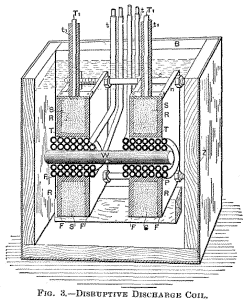

I have finished the construction of my first bucking resonant induction coil based on the coil that was in Tesla's London lecture. I have attached the basic coil layout and circuit diagram that I got from the lecture.
It is not a true replication because I did not use gutta percha wire in beeswax impregnated paper insulation, however, I calculated that the primary and secondary are the same surface area and it is wound in the same "bucking" configuration. Based on previous math, it seems Tesla's induction coil did not keep the surface area a constant between primary and secondary, so perhaps I will rewind the secondary for more turns.
It was difficult to tune, and it is still not operating with a voltage node on the terminals of the secondary (as it should be). The main reason for this is the difficulty of tuning a spark gap system as well as the fact that the bucking coils seem to cancel out electromagnetic induction. I can not even light an LED on the secondary by scanning for resonance using a function generator @ 20vpp.
However, using the spark gap "hairpin" circuit, I was able to draw (depressingly) small sparks off of the secondary that are brilliantly white in color and very loud. This shows me that a disruptive discharge certainly gives rise to "electrostatic" effects.

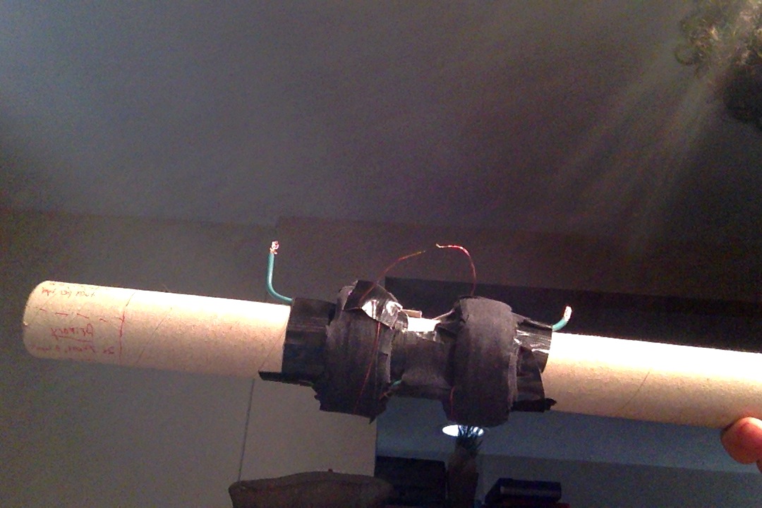

The construction of my coil is as follows:
Primary - 2X 3 layers of 14 AWG, 7 turns per layer for a total of 15.5 ft and 42 turns. (25 uH)
Secondary -2X 2 layers of 24 AWG magnet wire, 26 turns per layer for a total of 55.5 ft and 104 turns
Power Source - 50kv induction coil driven by a 9v battery
The primary is wound inside the secondary as is shown in Tesla's split coil diagram. It can be seen in his diagram that he used significantly more turns then I did. I wanted to create one like this, but it is very difficult to accurately measure the length of such a long wire, especially because the coil diameter changes with each layer. Both my primary and secondary are one piece of wire in my coil, which is not easy to do when constructing a multi layered bucking coil transformer!

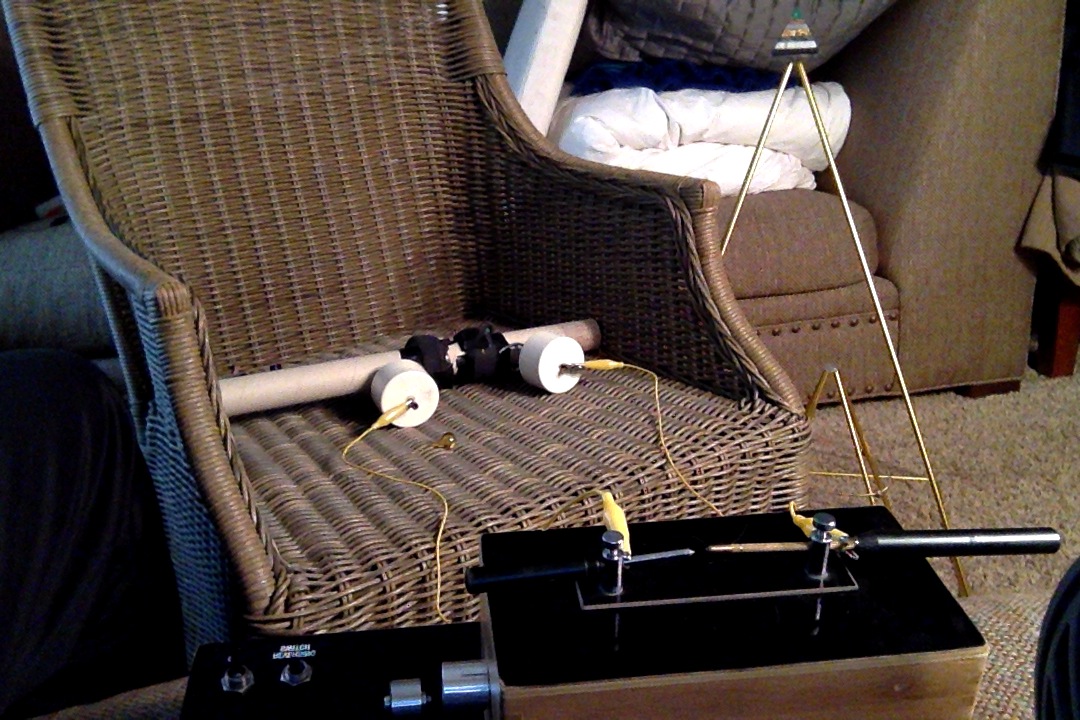

Here are some mediocre pictures of my set up. You can see the coils (which look like balls of tape) and the 50kv induction coil w/ door knob capacitors that I have been using.
I am using my laptop camera to take the pictures, so I don't want to risk having my computer near the coil while it is in operation.
The power source is currently two large 6v batteries hooked up and operating at a bout 8v and .5 amps, so there is significantly less power in the circuit than Tesla had with his high frequency alternators driving the coil.

Nice 50Kv induction coil you have there. You are probably just not achieving a resonant condition with the induction coil and its spark gap etc. What frequency do you expect it to work at or near?
