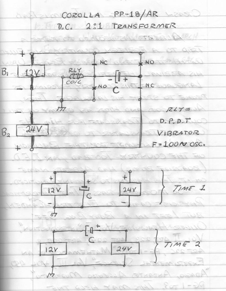

                      • Mr. Dollard,
                        I am still trying to understand dielectric parameter variation devices.
                        Consider your PP-18/AR voltage converter. Schematics are below.
                        Where and how does parameter variation occur in this device?
                        The condenser C varies its position in the circuit, yes: it goes from being located across the first power supply (V_1) to being located from the positive terminal of the first supply (V_1) to the positive terminal of the second (V_2).
                        By this transition it adds its stored potential (equal to V_1) to the continuous potential of V_1 in order to produce 2 * V_1 = V_2... or the opposite, reducing V_2 to one-half its potential.
                        And yet, at nowhere in this process does C ever change its capacity!
                        To be sure, if we were to add a second condenser, fixed in position across V_1, then a variation in capacity would indeed occur. After all, two condensers of equal capacity in series have half the capacity of either condenser on its own.
                        Is the parameter variation to which you refer?
                        The below document would seem to indicate so.

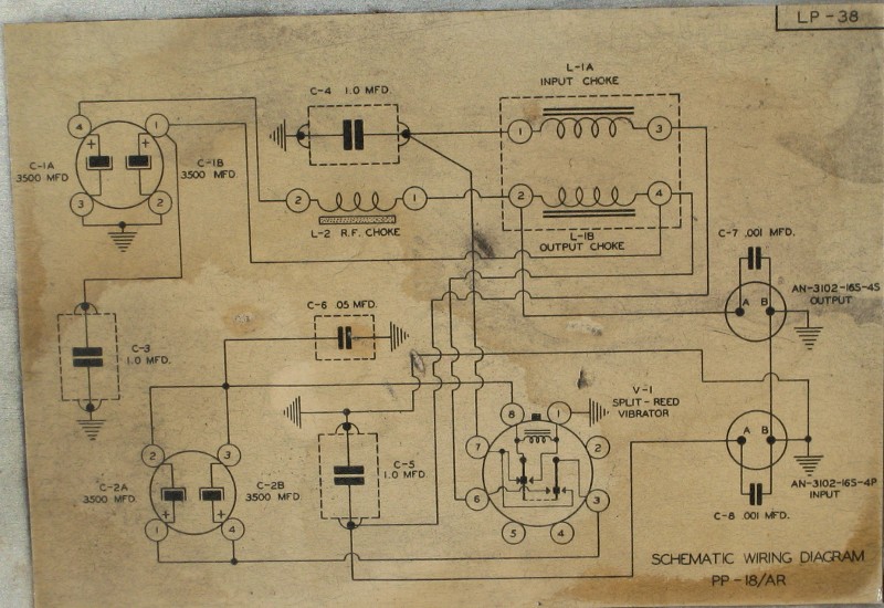

                        The difficulty for me is that not even the original military PP-18/AR converter contained such a condenser, at least not one of any significant size. The only other large condenser was used to filter voltage ripple in the output (across V_2)... not the input!
                        Nevertheless, I attempted to replicate the PP-18 voltage converter with a condenser across the V_1 input power supply to permit parameter variation.
                        I used 6800 microfarad condensers (across V_1 as well as as the position-varying C -- C-2 in the military schematic) and a split reed type vibrator operating at 116 cycles per second. 20 nanofarad condensers were used to reduce sparking across the vibrator contacts, and a 2200 microfarad condenser was used as an output reservoir (C-1 in the military schematic).
                        As specified, the device successfully produced twice the input voltage across the output condenser. Run "in reverse," applying power to the output side, resulted in one-half the input voltage, again as specified.
                        However, I did not observe any anomalous effects due to parameter variation. Once the initial current source (a 9V battery) was removed, the condensers ran down quickly and the device ceased operating.
                        Removal of the condenser across V_1 did not change this; instead the device simply stopped operating as soon as the battery was disconnected (as there was no longer any current available for the vibrator coil).

                          I am suggesting to Eric Dollard that this is exactly what is occurring in his PP-18/AR with the contacts of the multivibrator where a plasma exchange occurs at the gap after the spark is extinguished and travels back to the centre contact.
                          A cap across the gap is going to kill these effects and a need to fine tune the multivibrator for minmum arc.

                          • Smokey,
                            Thank you for the interesting post.
                            The concept of the spark plasma as a producer of anomalous energy surplus is not new to me. I have previously read claims that the spark gap in certain forms of Tesla apparatus performed this function.
                            The Steinmetz chapter in the "Transient" book on the phenomena surrounding lighting arrestors, which Mr. Dollard has posted several times, may also shed light on this concept. However I have not been able to fully comprehend this chapter.
                            It is therefore quite possible that, as you say, adjustment of the vibrator for maximum sparking is crucial.
                            Certainly in my case I designed the circuit for minimum sparking, in order to prolong the life of the vibrator. I could not imagine Mr. Dollard doing otherwise, given the scarcity of suitable vibrators and the necessity of functional power conversion in his Corolla.
                            However, I have reason to be skeptical that sparking at the switching contacts is a crucial element of the circuit.
                            First, sparking ought to produce no change in any dielectric parameter variation, except possibly in terms of the rate of change of the parameters.
                            The rotating variable condenser device developed by Chris Carson did not appear to require any kind of spark gap. It is possible that the Carson device was nevertheless able to produce a comparable capacity time rate of change through extremely high-RPM operation, but I doubt it.
                            Next, an earlier attempt on my part to replicate Mr. Dollard's results with the PP-18 circuit produced a great deal of sparking, but also no anomalous results.
                            In that case, I used an ordinary electromechanical relay with an operating frequency of approximately 40Hz. There, the result was precisely the same as with the vibrator.
                            As it was a very brief test, the relay was a modern type with long life contacts, and relays are easy to come by, there I took no measures to minimize contact wear. The result was continuous and visible arcing at the contacts. Yet the circuit still ceased operating upon removal of the external power source -- rather than continuing to operate and producing ca. 100mA surplus.
                            At the time I assumed that there were one or more critical thresh-holds pertaining to operating frequency and switching delay. The electromechanical vibrator performs considerably better than the relay in both of these respects. However, my most recent test with a vibrator would seem to invalidate this hypothesis.
