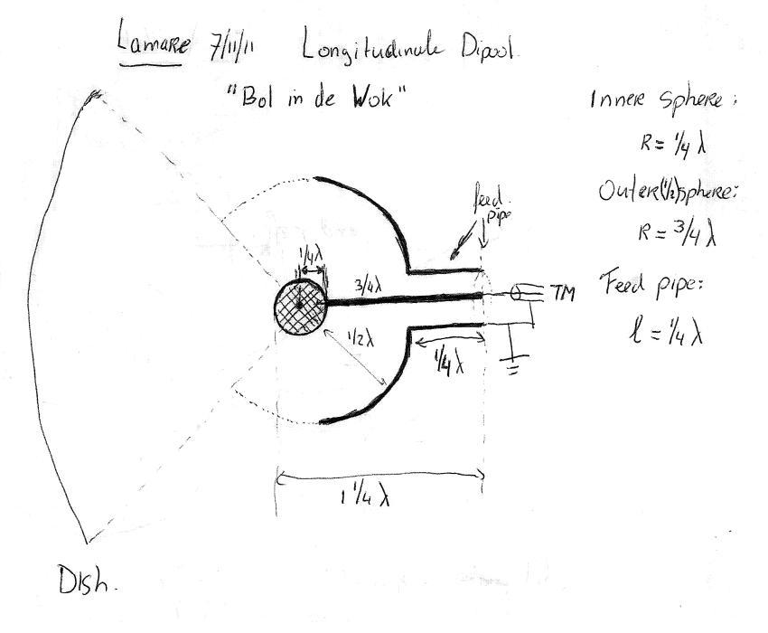

                  The lamare longitudinal dipole antenna (and/or dish feed)...
                  Yesterday evening, I have been thinking about how to design a longitudinal antenna for use with a normal transmitter. The design used in the Swiss proof-of-concept was fed from the centre, but the coax mantle was floating, which is not such a good idea. This kept bothering me and after some deep thinking, I suddenly got an idea. The lamare longitudinal dipole:
                  The idea is to make a whip antenna of 1 1/4 lambda, where at the tip of the whip we mount a sphere with a radius of 1/4 lambda. Concentric to that one, we mount a hollow sphere with a radius of 3/4 lambda.
                  So, in between the spheres you have 1/2 lambda, so both are at a voltage node with a phase difference of 180 degrees.
                  The outer sphere acts as a reflective shield. I have drawn this one as a half sphere, but of course you can match the opening in the outer sphere to the angle of your dish, and you get some gain as a result.
                  Since a normal transmitter is designed to couple into a current node, we attach a feedpipe (or how do you call this?) of 1/4 lambda to the outer sphere, which is connected to ground at the feed point.
                  The inner sphere is connected to the same feed point by means of a 3/4 lambda whip.
                  The interesting thing is that because of the difference in propagation speed of a factor pi/2, your transversal resonance frequencies are also a factor pi/2 away from the frequency for which we design our longitudinal dipole, which causes a nice suppression of all the transversal junk we don't want in this case....

                        @lamare
                        nice concept and design.
                        you will be able to fine tune it with the pipe I presume.
                        2 questions....
                        What kind of voltage do you predict on the node?
                        and how do you plan to switch it from the transmission mode to receiver mode?

                          I have no idea at this moment how to calculate voltages on the antenna. Have to figure that out. It is an interesting question, though.
                          In principle the antenna design works exactly the same as a normal whip antenna of 1 1/4 lambda from the transmitter / feedline's point of view. The only difference is the geometry which is designed to generate longitudinal dielectric waves instead of transversal waves. The antenna should work both as a transmitter and as a receiver antenna equally well.
                          And since with a moonbounce we have a return time of about 1.6 seconds, we can transmit a signal for about 1 second after which we have "plenty" of time (about 0.9 seconds) to release the TX button and receive the signal bouncing of the moon trough the same antenna and tranceiver. So, for the actual experiment we only need one antenna and one transceiver, which is very nice, because those 25 meter dishes do not come in large quantities.
                          At the moment, I am investigating the possibilities to realize an antenna for the 1296 radio amateur frequency which is "reserved" for moon-bouncing activities. Since in The Netherlands there are no ERP rules and a maximum of 120 Watt output power is allowed for 1296 MHz, we can kick some a** with this 25 meter dish, that's for sure.
                          However, I still have to arrange a powerfull 1296 MHz transceiver, but first things first. Before we can do anything, we have to build ourselves an antenna....
                          The dimensions I calculated for 1296 MHz:
                          lambda: 1.57 * 300/1296 = 471/1296 = 36,36 cm.
                          3/4 lambda: 27,27 cm.
                          Diameter "wok" - the big one - : 54,54 cm.
                          1/4 lambda: 9,09 cm.
                          Diameter "bol in de wok" - the small one: 18,18 cm.
                          Length feed pipe (balun): 9,09 cm.
                          I would love to have some idea about what kind of error margins are acceptable. The Swiss proof-of-concept suggests an error margin of up to 10% can be acceptable, but this kind of a challenging operation, so I guess we would have to stay within 1 cm of error for the spheres.
                          For the construction of the large sphere, I am currently looking at the possibilities of realizing a design similar to this:
                          Radio Astronomy Telescope Project
                          So, the idea is to make some kind of support structure with ribs and use some kind of mesh to make the reflective sphere.
                          Probably these can be constructed using flexible copper tubes. Then we would make a couple of rings and parts in the shape of half rings and solder these together to make a support structure.
