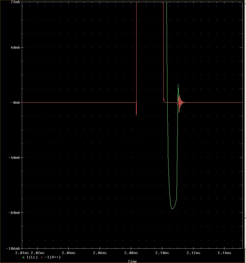

      • Shunt in Series with the Battery
        Here is a nice scope shot of the coil current (green) actually reversing (unless MH has a different explanation), but no current going back into the battery (red trace).
        This is with the current shunt in series with the battery.

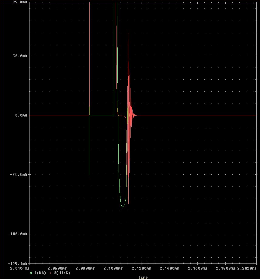

        Edit: I've added a shot of the flyback diode current (green) vs the MOSFET Gate drive voltage (red).

          • Originally posted by poynt99 View Post
            .99

            • Good grief Rosemary,
              These are MY scope shots from my simulation. I did say "sim" in my post.
              If you are trying to make the circuit unstable and more "noisy", then putting the shunt in the Source is the way to go.
              You have to give us a bit of patience here as we designers always try to use good practices to minimize noise etc., not enhance it.
              If it makes no difference then that is my recommendation for any future testing, including replications here.
              .99
