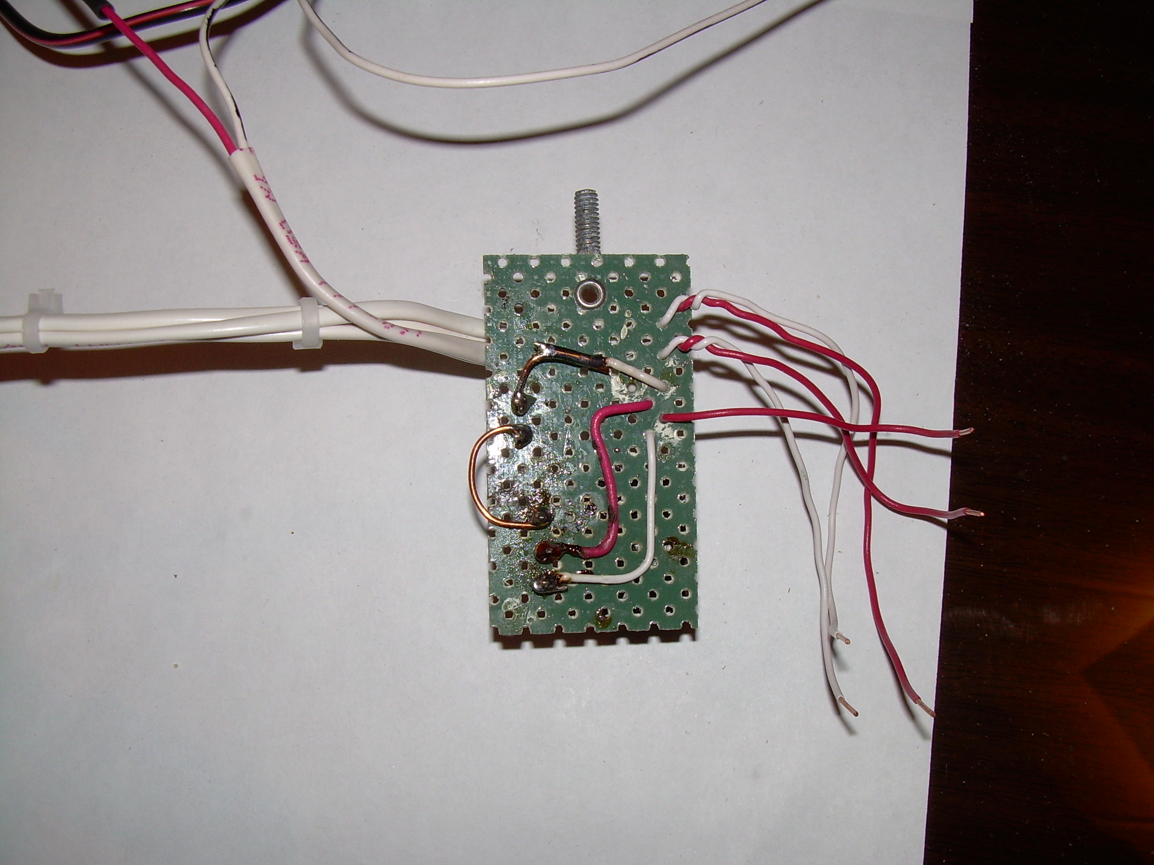

    • Hi Greg,
      I found the images on Glens 'Devices and Components' Repository:
      Device & Components - Windows Live
      This Image shows all four scope probes connected to a common location:
      And this image shows the actual common node 'Wire Tree' fabricated to do this. You can see the four copper protrusions over the white wires:
      Attached is the original shot along with my suggested modification
