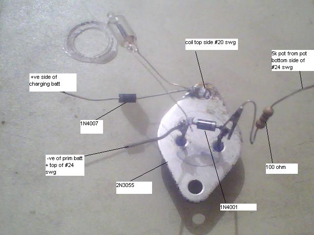

    Hi every one I am trying to replicate SSG energizer but still didn't get success
    i also up loaded my circuit diagram so it would b easy for me and you all bros to explain me i am 12 v 4ah batt coil is #20 swg and #24 swg with 350 turns filled with iron nails when connect top side of coil to +ve of batt it repels the rotor but when attach it with circuit it didnt show any thing plz help me and first tell me is the circuit is ok or not
    From your picture it looks like you have connected it in attraction mode. Try connecting the top of your drive coil (#20) to the +ve of the battery and the bottom of the coil to the collector of the transistor. In that case the top of the trigger coil (#24) should be connected to the pot that is in series with the resistance and the base of the transistor and the bottom of the trigger coil to the emitter. Also, just in case you didn't know this, the ssg is not self-starting, you need to give it a spin by hand to get it going. If it still doesn't work check your transistor just to be sure.
