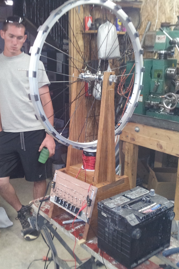

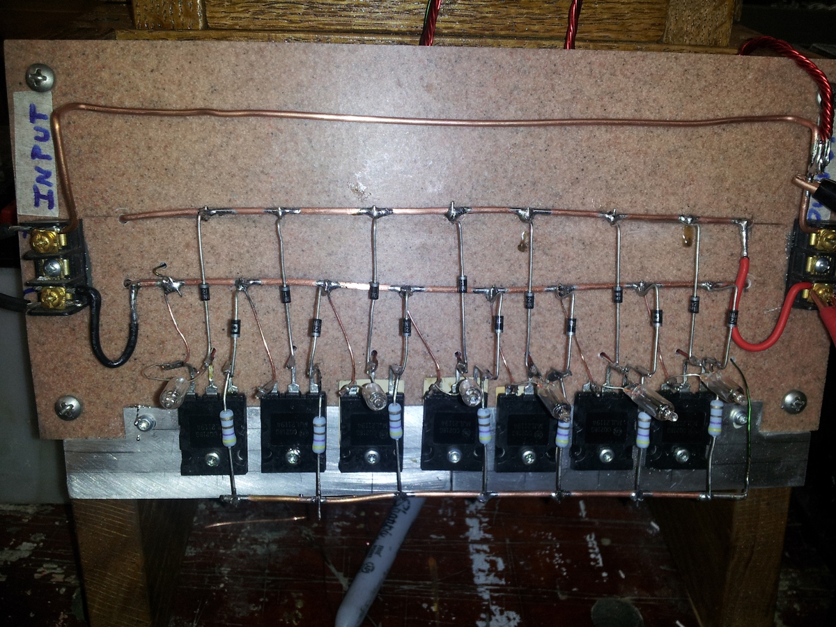

    Hi gang! Better late then never! I have a lot of catching up to do. Today I built my first SG. I built it with the help of Johns Book #1. I did it exactly like he said. Cause he says "build it just like this". So I did. or at least as close as I could. I have a close up of the circuit so you can see what I did.
    got it all hooked up, and spun the wheel the wrong way. Of course it dident run. then it dawned on me, so I spun it the other way. YeeHaw! she took right off! so to "test" the circuit, I pulled the pos off the charge battery. thats where it went wrong
    the 2nd light from the right blinked a couple of times and went out. None of the others came on. I hooked it fight back up and it still ran, but slower. so I did a finger temp test on the transistors. 2 on the left were HOT! the others were cold. everything is per spec as far as I can see. So i did some testing, I have no idea how to test BJT's but the values seem consistent except the 2nd one from the left. I put in new diode, no change, new resistor, no change. removed the neon bulb, no change.
    eplanation of the picture:
    "top of the coil" comes in on the right with the trigger wire coming in through the hole, connected to the resistors. Bottom of the coil connected to the transistors, with the trigger wire coming in thru the hole on the left, connected to the?collector? the pin on the left when upside down
    The rest is visible as far as how its assembled.
    So what went wrong?

    Congratulations on your first build!
    It actually doesn't matter which way you spin the wheel because the magnet polarity in relation to the coil's magnetic polarity will still be the same. Should run both ways.
    One thing I would do that isn't directly related to the circuit is to clean off the battery so that there is no residue on top of the battery that can cause a very subtle short between the terminals and use a battery terminal cleaner (circular bush) to make them nice and shiny. You want good connections and a clean battery case.
    I see one battery, did you even have it hooked to an output battery? If not, you could potentially fry all the transistors. Make sure when you have a coil with this many windings and at those lengths that you only run it with a battery on the output or you will get too much back pressure in the transistors.

      Thats an Alum battery. It probley does need cleaned off though.
      Yes there was a second battery. All was done down to fine details by the book. Thats why I am so confused as to why it ran, then quit. Thats a lot of time and money to spend for a 10sec show!
      I looked up testing a transistor, but my multimeter does not have a cap tester. can you test the trannys with ohms?
        Hi Shadow.
        An easy way to check if you have a short is disconnect all the power windings from the + terminal of the run battery. Then with the charging battery hooked up and an analogue amp gauge connected hook each power winding up one at a time. If you see the gauge move then you have a short circuit or damaged transistor on that particular power winding. Sometimes its only one thats damaged, sometimes not.
          the first of many fried transistors
          Congrats on at least seeing it spin the first time. I am guessing since you lit up the neon you may have fried the tranny. If your coil gets warm with the primary battery hooked up you will know for sure. you can ohms test across the tranny and see if it is comparable to the others [out] of the circuit, you will have to pull them out of the circuit or the test will travel through the resistors. Don't be discouraged, bump in the road. Al
