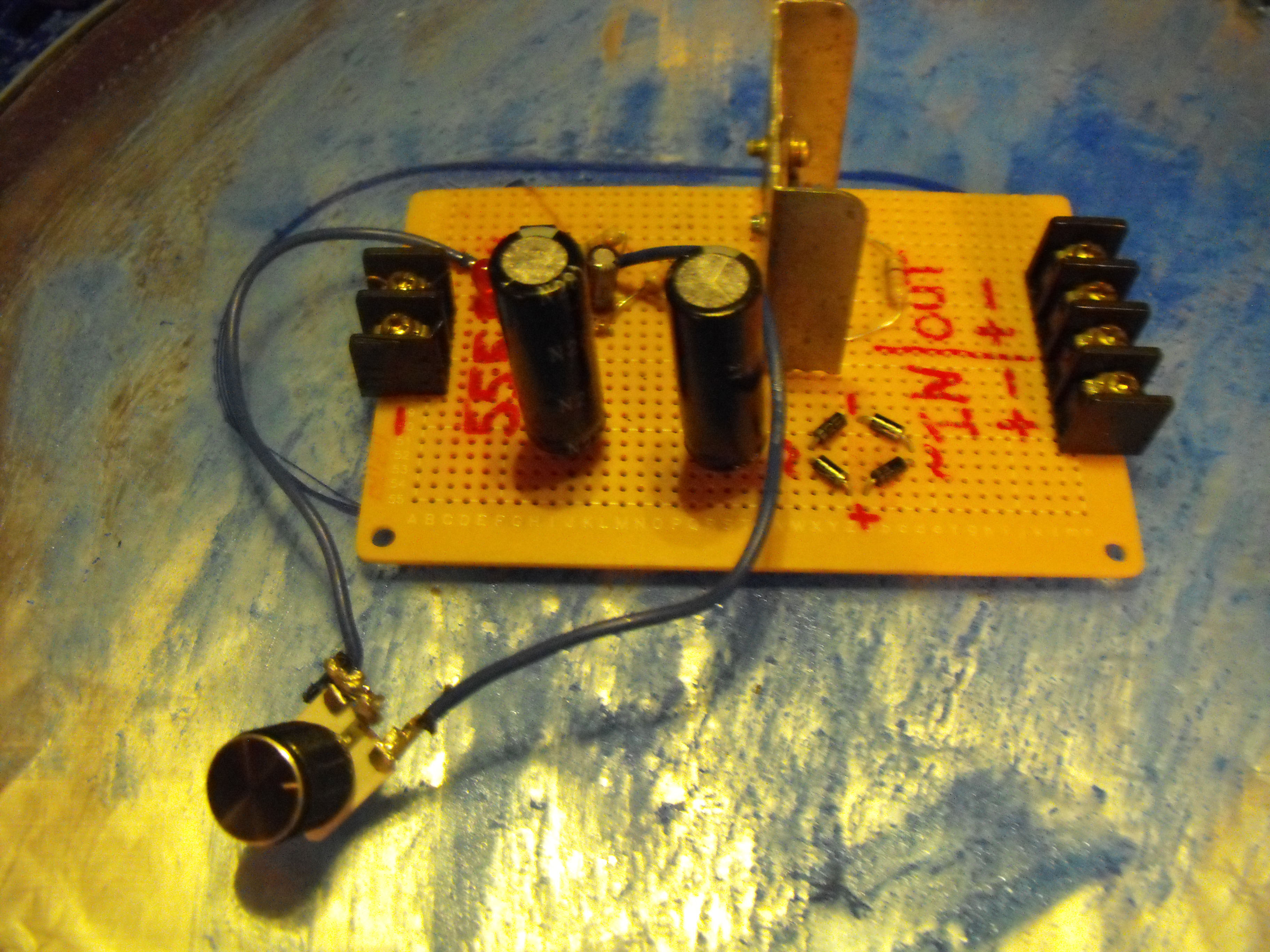

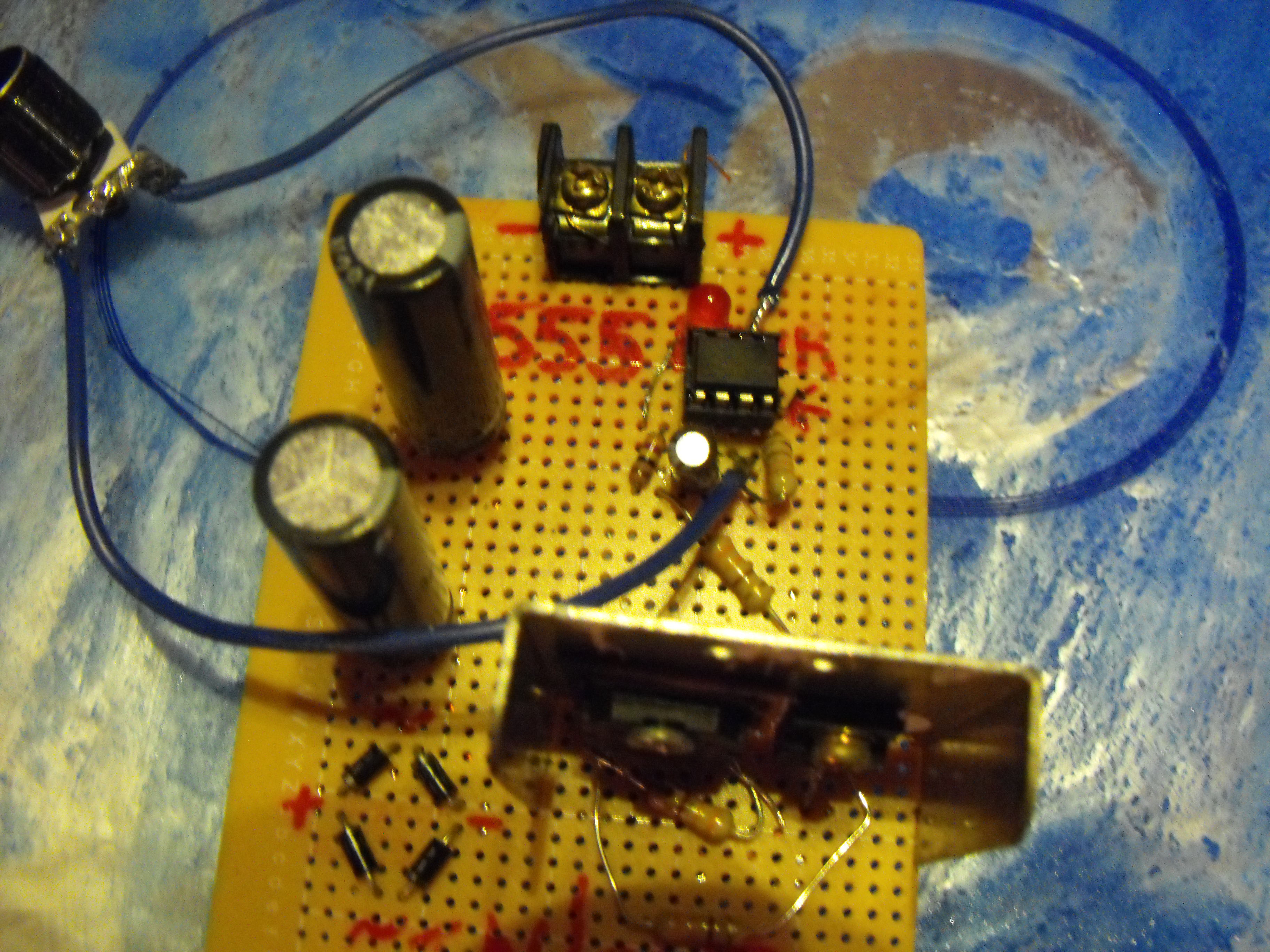

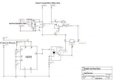

I have built a capacitor discharge circuit that allows me to just hook up the output from one of my many energizer circuits I've built and then the cap pulsar's output to the battery.
This was my 4th attempt at a cap discharge circuit, this one works perfectly. There is a 100K OHM pot between pin 7 and 2 of the 555 used to turn on and off the MOSFET that allows me to change how quickly the 555 pulses.
When I have the frequency at a pretty high rate it produces a constant output voltage of about 25 volts which keeps the battery in full charge mode and allows a great rate of charge.
I am including a schematic as well as some pictures of my setup so anyo9ne could replicate if they wish. If anyone needs some help with it then please let me know as I am eager to help others learn about alternative energy sources.
