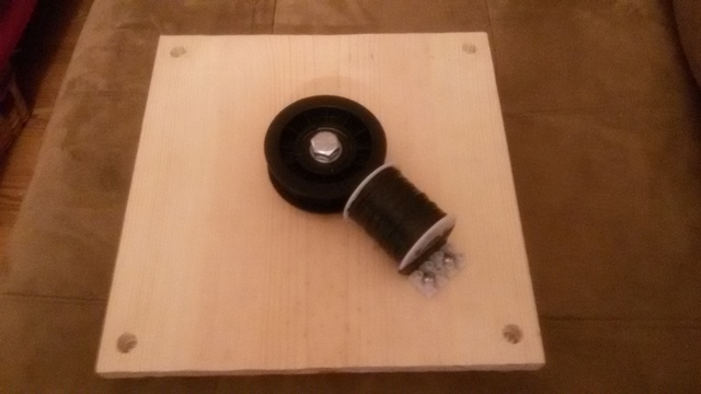

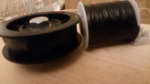

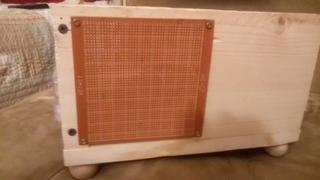

    I used steel, re-bar tie wire for the core material (from the concrete section at the hardware store)... And I used a standard terminal strip for the connections...
    The rotor is a simple backside drive pulley for a lawn mower... I cleaned out all the grease with carburetor cleaner, and used my air compressor to blow it all out real good. I then used a few drops of oil made for my electric razor to lubricate the bearings just a little. It spins very easily!!!
    I super-glued 4 neodymium magnets, spaced evenly apart onto the pulley, and then wrapped electrical tape around it very tightly... Hopefully the magnets will not fly off! I think I got them on there pretty good though.
    Here's the pics of what I have so far...

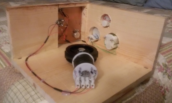

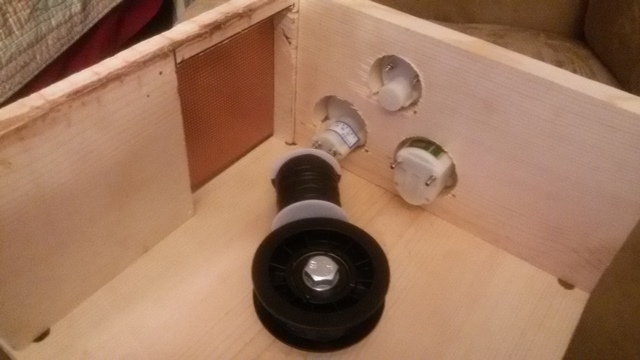

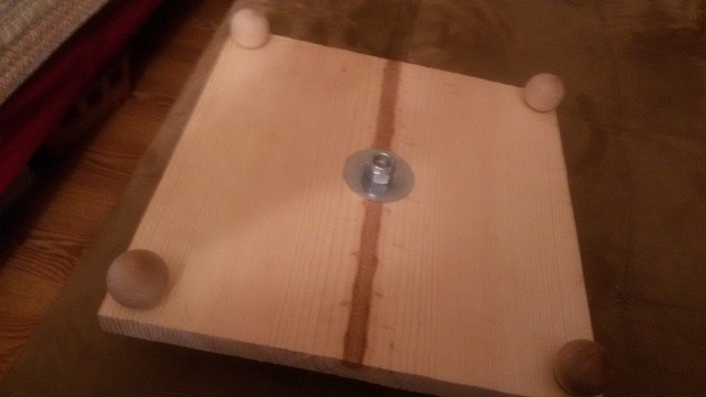

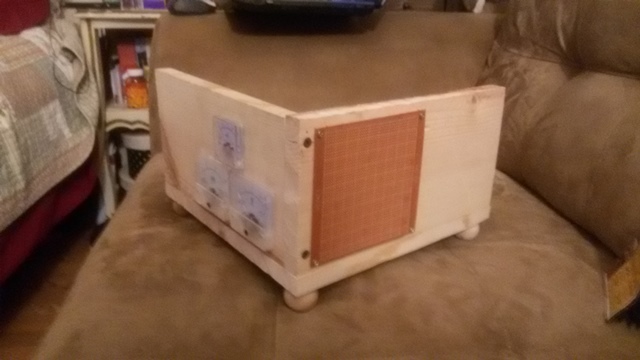

            I found a few minutes to work on it a little today... since my parts finally came in!
            Here's a few pics....
              well, I got it together and running today

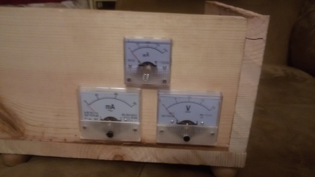

              Now I just gotta figure out how to hook up these meters I bought...
              Ill take pictures tomorrow evening and post... but hey, its running

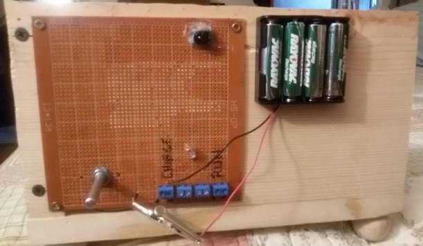

                Here's the pics I promised...
                I did switch out all the magnets to ceramics and noticed that the wheel spun much better... However I think I need to build a new coil.
                The coil I built I used 20 and 24 gauge magnet wire, but I didn't count the "turns" as I rolled, I just used ALL of the wire I ordered, which was only 158 feet... I'm guessing that is why I am not getting very much current or voltage coming from the motor even when I spin it up with 12 volts...

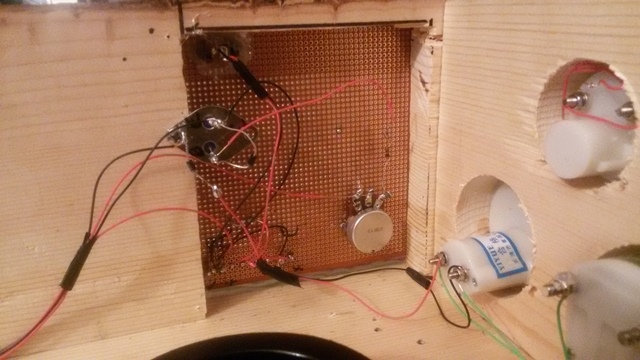

                Also, I am using a 10k pot... not a 1k. I have very little control over how fast the thing spins... Its like I have to have it turned up all the way for it to take off, and when I back off even just a little the whole thing stops. Is it because I'm using a 10k pot? or do I have the pot hooked up wrong? Please see the pictures to see how I have it hooked up.
                Can someone explain to me how the winding's relate to increasing power? Im still unclear on how that works, and how to get the maximum benefit from the coil.
                I also installed a power jack so that I can plug in a "wall wart" for source power while testing the output... But I still cant figure out how to properly hook up the volt and amp meters... any help would be appreciated.
                  well... Murphy's law hits again!!! Apparently I had something hooked up wrong, and I've fried 2 transistors as well as the 10k pot!
                  I've re-built the entire circuit, and just now trying to figure out what to use for a pot since all I have is an audio volume control here... I think I'm going to order a wire-wound 1k pot as I've heard that you cant really fry them like these ones from Radio Shack.
                  I did figure out how to hook up the amp meter... but I'm still not sure how to hook up the volt meter without causing a short... I could use some help here guys...
