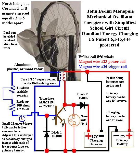

                    Please Help me understand the basic SSG circuit
                    Originally posted by elias View Post
                    In conventional terms, there are two cycles in this circuit:
                    1- The transistor is ON
                    2- The Transistor is OFF
                    At 1 the current charges the coil with magnetic field, by drawing some current from the primary battery.
                    At 2 the magnetic field collapses and discharges into the secondary battery. So the secondary battery comes into the circuit when the diode is ON, and the diode cannot be ON when the transistor is ON in conventional terms. And when the transistor is OFF no current is drawn from the primary battery. Connection by only the negative side is not enough. They hold only one common at any moment of time.
                    Elias

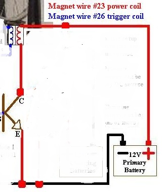

                    Firstly, I am just learning about electronics, period.
                    I keep reading this over and over and looking at the circuit and I just can't visually make a route in my mind for each cycle.
                    I have attached a file for what I currently believe or visualize might be the "first cycle" where the power coil is fired, transistor on.
                    If I were to erase all of the irrelevant stuff in the original image, for cycle two, and depict the transistor open... what would be left in my drawing?
                    I also understand that diodes let current flow one way, but how does one equate this to on/off? Is on when current is travelling in an allowed direction, and off is when current attempts to enter where it cannot?
                    Thanks for any help. I about to build this thing, and honestly I am not completely stupid...LOL just trying to understand.

                      Hello kcarring and welcome.
                      I put a diagram for transistor off below.
                      Yeah I think that's what Elias means where you quoted him.
                      You have a fairly good understanding so far.
                      Keep asking questions if you don't understand.
