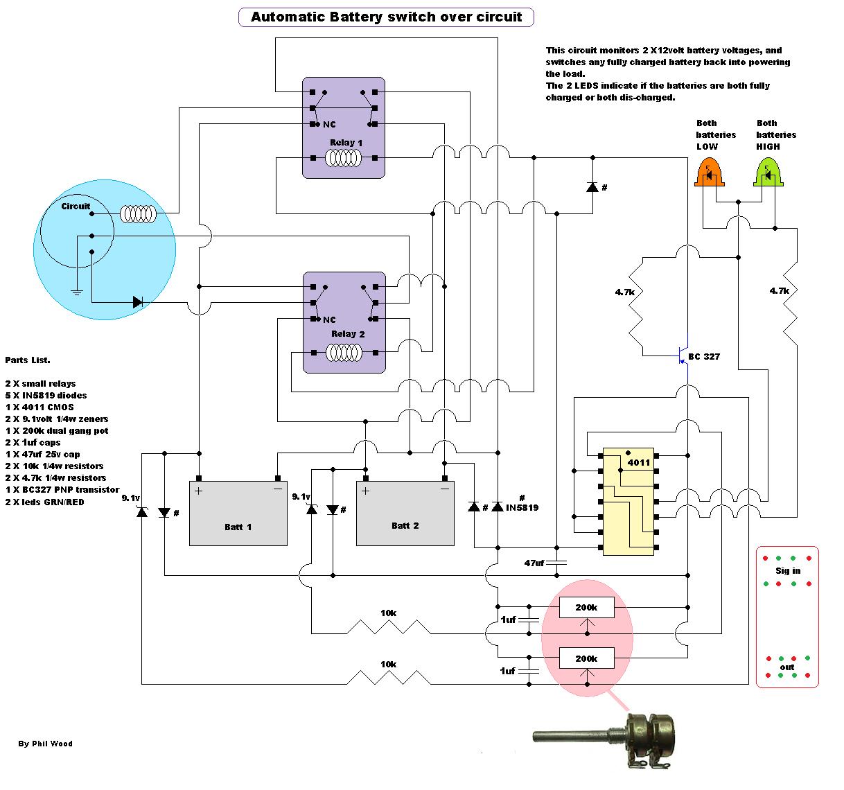

    See Battery Swapper schematic .

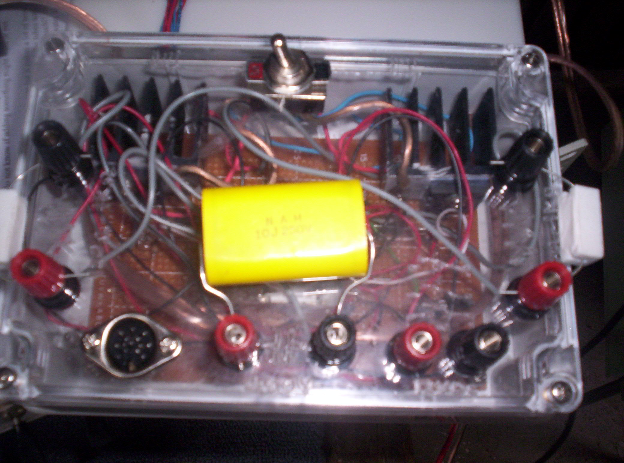

        And whilst we are at it we are going to test this relay circuit on RF"s fan kit.
        See here we made the Fan kit to be able to accept the relay circuit.(plug in) Now don't know how many bugs are on it, will soon find out when it doesn't work

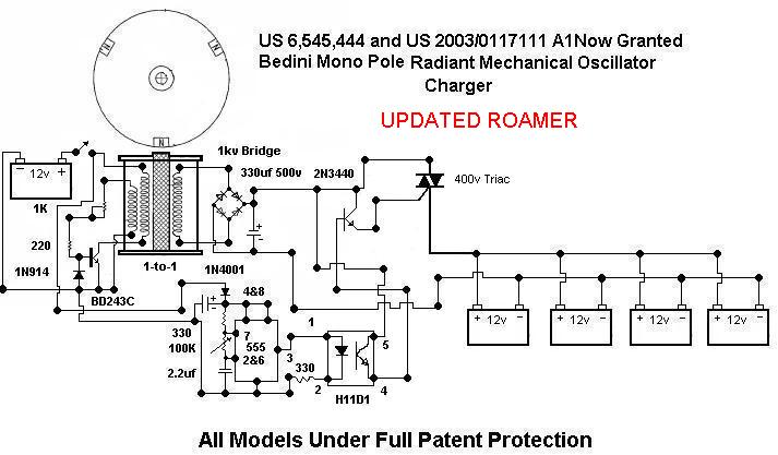

          Guys sorry for the double post, now what about the attached 4 battery rotator system, what we really need is to find some circuit which can close the loop, IE- let one rest whilst one charges as JB says.
          I have not been able to find any circuit yet but thats what we should work on IMO.
