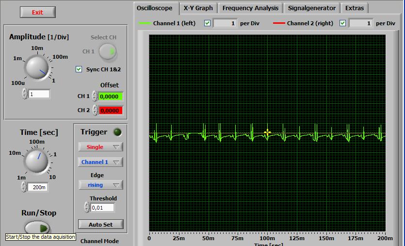

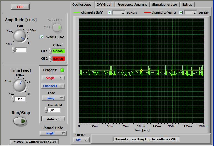

    Scopes, with one or two rotors running.... rare results
    Look this shots, with one or two rotors....
    Running two rotors, radiant energy is some strange
    can somebody help me to know about this shots????

      My take on the scopeshots is in pic2 when you have both rotors running they are slightly out off sync so both rotors are triggering the coil.The magnet placement on the rotors has to be identical so the rotors run syncronised so triggering the coil at the same time.This is the way to get the same current draw as if there is only 1 rotor.
