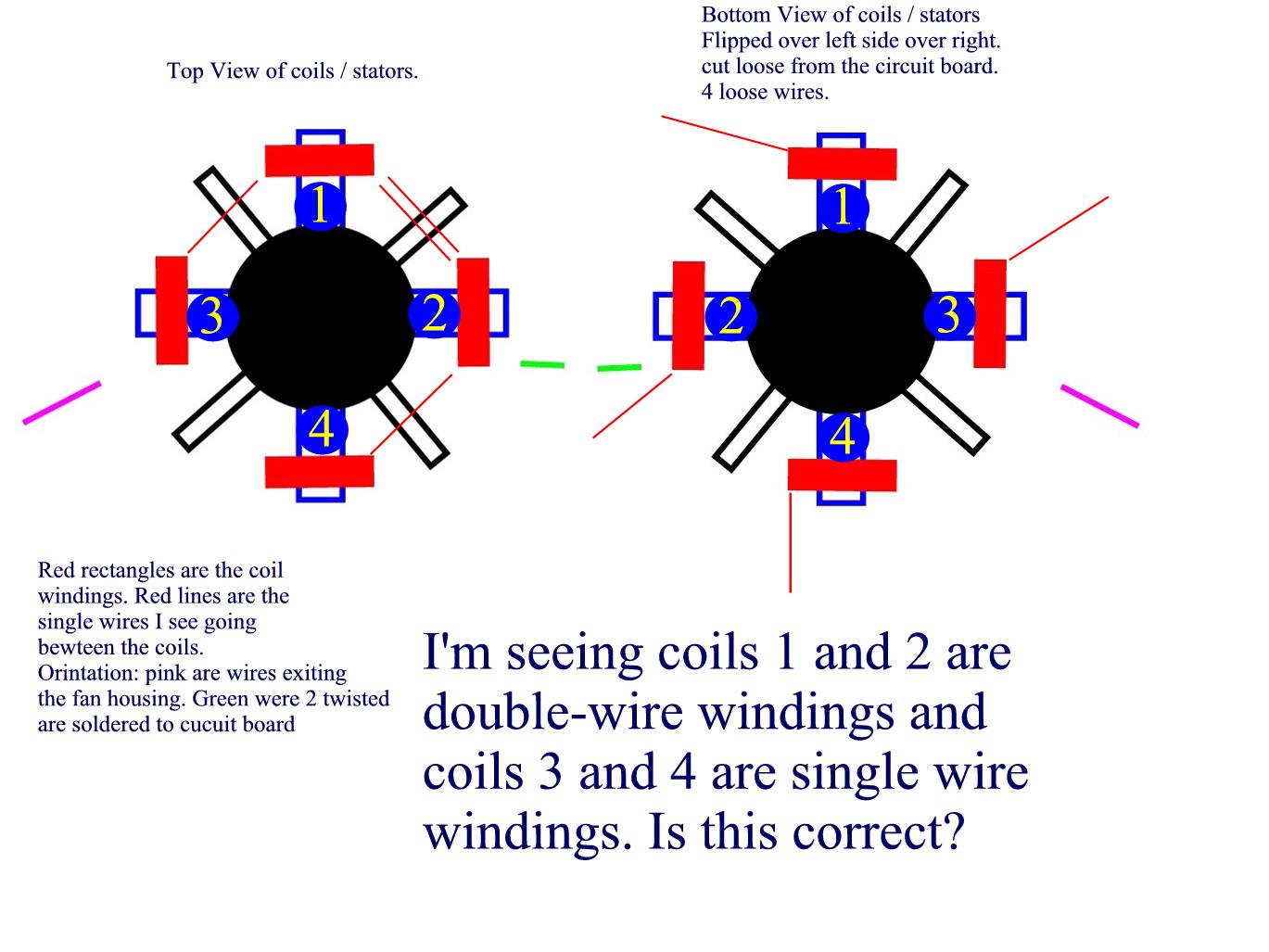

p1) stated: The statement is made there is a single wire is making up
the coils. (I don't know were in the video that was said)
This started my confusion.
A single wire means to me, I'd expect to find a single start/end pair of
wires leaving all 4 coils.
I find 4 wires soldered to the fan's circuit board.
I must conclude then:
Is there 2 single wires making up 2 coils each
to have 4 wires total exiting the coils and soldered to the
fan's circuit board?
I guessing it was meant that the coils were not double wire wound
when it was said a "single wire" was used?
P2) @16:52 "and then you'll find two other wires soldered to
the circuit."
This jives with P1, but I have 4 wires and 3 solder joints.
2 single wires and 2 twisted together, making 3 solder joints on the

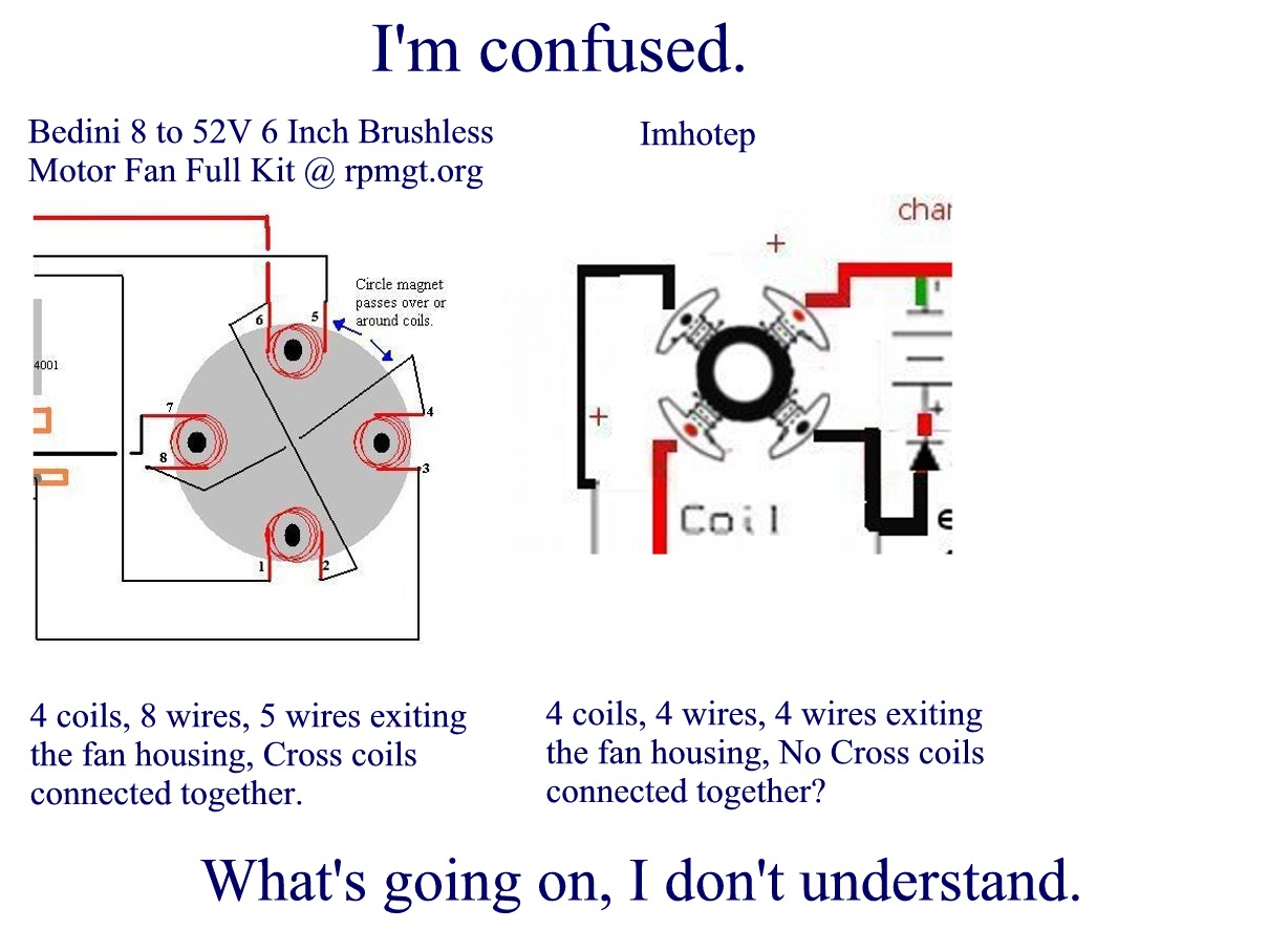

? looking at BrushlessEnergizer1.jpg I think I only see
5 wires exiting the fan housing.
Is 5 wires exiting the fan housing correct?
With what I am seeing (wires) and what I understand at this point,
I make 4 wire cuts (top side) at each coil and cut the 4 wires off the
fan's circuit board. That would give 4 start/end pairs for each coil.
That gives 8 totals wires, is this what I need to do and is correct?
Looking at the circuit layout in BrushlessEnergizer1.jpg (BEpic)
I see only 5 wires exiting the fan housing, is this correct?
8 wires, 4 start/end pairs for each coil.
I count a total of 7 new wires added inside the fan housing,
2 connecting opposite side coils and 5 leaving the fan
Is this correct?

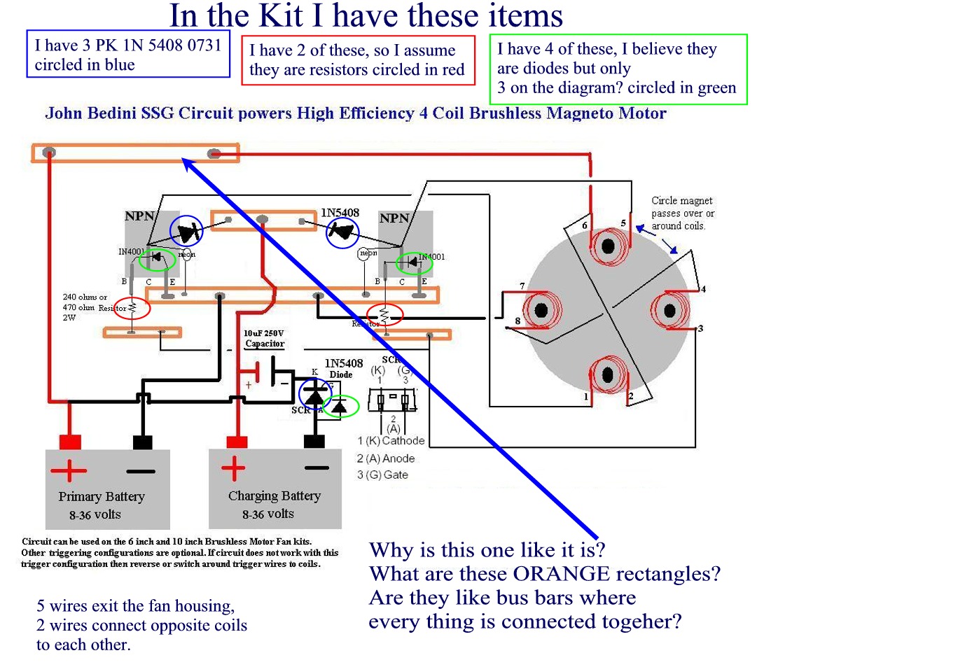

I have 2 MJL21194, an internet search tells me the
TIPO of MJL21194 is NPN and the P/OUT
1-2-3 is BCE. Now I know the MJL21194 is the NPN
on the diagram (BEpic).
Question: BCE (pins) are left to right with the
label MJL21194 upwards and readable, Correct?
I have 1 2N6509G, an internet search indicates, to me,
2N6509G is the item marked SCR (K,A,G) in circuit?
I've attached Questions.jpg that have a few questions
about BrushlessEnergizer1.jpg.
