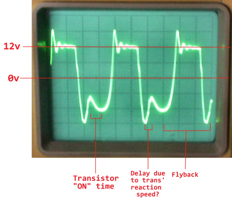

    Hi Everyone,
    As you know I recently got myself an oscilloscope!
    Here are a few shots from the scope.
    Firstly, here is a fairly standard H-Wave which you would expect to see when there is no load (ie. the charging battery is disconnected)

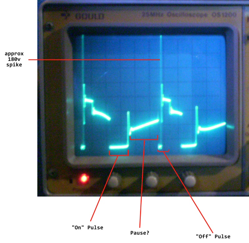

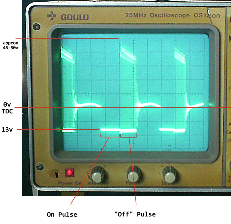

    and here are some anomylous waves that I don't quite yet understand!
    This one shows a delayed "Off Pulse" (flyback). You see the coil turns on around TDC (Top Dead Centre - when the magnet is directly over the stator) then turns off, then there is a pause, then the flyback shows up! No idea how that is happening.

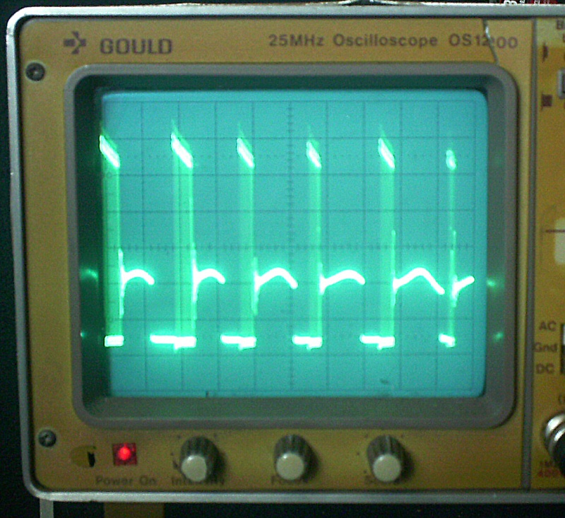

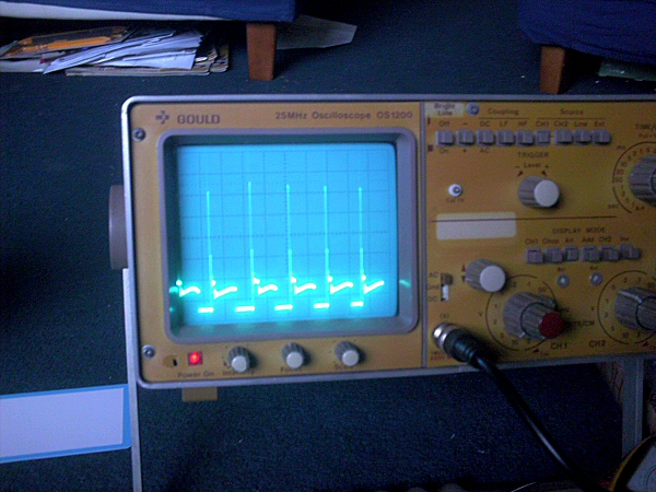

    and these shows a resonating "off pulse", or rather a series of spikes... very odd... only shows up when using two coils with thier recovery windings wired in series and using a reed switch as a trigger.
    Any comments on the anomylous scope shots would be appreciated, but feel free to ignore me and use this thread upload your own shots!

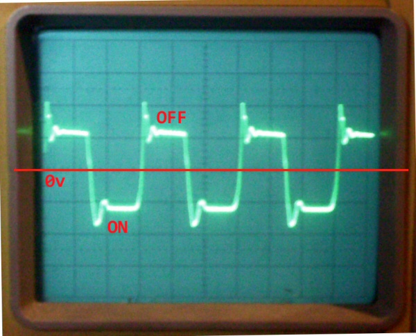

          ok, I have been studying the waveforms from my solid state oscillator and I think I have found the ideal wave. Haven't seen this posted anywhere so it may be useful!
          If I increase the resistance slightly it will go chaotic. If I decrease the resistance the curve on the bottom representing the ON time levels out and resembles the wave I posted earlier.
          I think I understand what is happening but if any of you learned individuals would like to jump in with some coaching feel free!
          What I see happening is almost like an electromagnetic equivellant of a pendulum.
          when the transistor turns on it charges the coil and then turns off. The voltage then "swings" (like a pendulum) in the opposite direction and we extract a little bit of energy from the swinging. the voltage then swings back in the direction it originally came from and when it reaches the apex we give it a little nudge (turn the transistor on to charge the coil) to maintain the swinging motion (the oscillation).
          We want to provide just enough of a nudge to maintain the oscillation so I have tuned the oscillator to turn off when the voltage reaches it's peak, just slightly after the bottom curve levels out as this indicates the coil has reached saturation.
          Don't know how you are supposed to tune a solid state oscillator without an oscilloscope! I love it!!!!

            I think I worked out the frequency though the ideal frequency will probably vary from model to model... but just for the record, the scope shot above is showing the oscillator resonating at 3.3333 kilohertz (exactly 30 microseconds between start of pulses)
            The transistor's ON time is approx 5 microseconds.

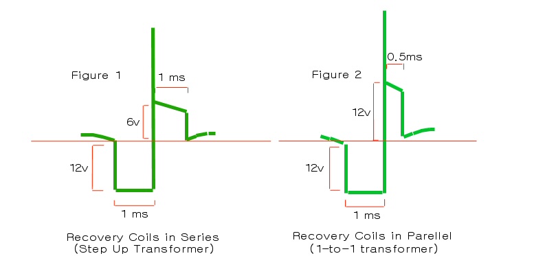

                            I've noticed something interesting while studying a few different configurations on my energizer...
                            These are some approximate sketches of my waveforms from my energizer which currently have two seperate coils. Figure 1 shows the wave when the recovery coils are in series and Figure 2 shows the wave when the recovery coils are in parellel.
                            Now, obviously this doesn't mean that only 6 volts is being output by the first configuration and 12 by the second. The output on both these cofigurations will be almost identical ie. They will be just above the voltage of the charging battery. Let's say 12 volts.
                            But here is where it gets interesting! Both of these configurations are outputting at the same level, however the first configuration is outputing 12 volts for twice the time! Isn't that interesting...
                            But it gets just a little bit better... doesn't the prolonged output of the first configuration indicate that the magnetic field from the coil being energized is also prolonged and thus gives us some extra work by continuing to repel the rotor magnet for a longer time after the supply voltage has been cut off?
                            Maybe I am just misinterpreting the scope shots so if anyone would like correct me please do!!!
