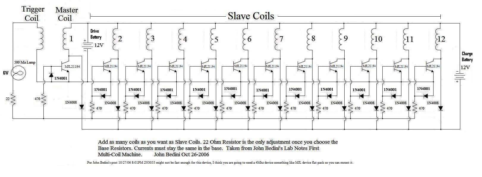

            With the monopole, how much voltage/amps should be the max for 6 transistors ( I am trying to gauge how hard I should be driving my setup )?
            Watching the videos of Bedini, he uses up to 10 AMP on the large machine, and much less for the smaller machines.
            See my experiments here...
              I find 200-300ma to be about average per winding. It will probably vary a bit depending on wire guage, length of wire, number of turns etc... anything over 500ma would be too much and would generate alot of heat.
              Not absolutly sure about the configuration of John's big monopole, but I believe I read somewhere that each coil has 5 windings. My guess is that 4 of those windings on each coil are primary/slave windings which would make 250ma per transistor.
              I think the fifth winding on each coil would be a recovery winding and I don't think it has a trigger coil.
              If all 5 windings are primary/slaves then it would be 200ma per transistor.
                Then again, I don't think he is running it on 12 volts either... I think it is 48v. With 12v I find a 25% (approx) duty cycle gives the best rpm so a higher voltage might reduce his duty cycle to around 6-7%... but I'm just speculating...

                  Big machine specs...
                  From
                  John Bedini and Peter Lindemann's Medium and Large Motor-Energizer Project
                  "In the last few months, John and I have built two large, multi-coil machines. One of them runs on 24 volt, 450 amp-hour batteries and charges a second equally large battery bank. The second one runs on 24 volt, 1600 amp-hour batteries and charges a second set of equal size. This last unit is our first set of experiments with a battery large enough to run a solar home! At the end of the charge cycle, these 1600 amp-hour batteries are boiling at 31.2 volts!"

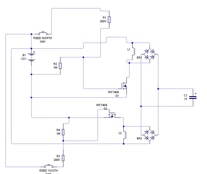

                      I've modified my SG, to runnit with Hall IC and trigger coil as recovery....
                      I can not, controll amp drawing, so. Now S pole
                      SETUP N-S-N-S, give good torque but amp drawing is up
                      What you think?

                        Hi patmac, i have succesfully modified my bedini sg with the hall sensor ic, it switches with north and south (es211 http://www.eastera.com.cn/data/ES211-ENb_a.pdf ), i put 2 power coils with two mosfets irf740b, 12 volts battery, a voltage divider for irf740b (basically two resistors), it draws 200ma at 12v and it run like a tornado and have significant torque, and the back emf production is ok, plus i have a additional coil on the back of the power coil, YES on the back and is producing some unusual power 6 volts 100 ma.
                        One power coil drives the south magnet and another power coil drives the north magnet, so no especial and difficult circuit is needed .
                        I will upgrade it, so no videos because it looks horrible.
                          I will upgrade it, so no videos beacause it's look horrible.

                              In order to have the circuit performing you will use the mosfet that the schematic shows, so if you have to put 24 volts input power you will calculate the resistor with the simple voltage divider ecuation, irf740b is rated for 10 volts max for gate voltage, so if you don't want destroy the mosfet you will do like in the schematic!
                              I have upgraded my circuit with hall sensors but it is on my head, my software is limited and doesn't have a hall sensor in order to do the schematic! sorry
                              The extra coils, are not showed in the diagram, but it is the Doug Konzen idea.
                              I have been doing like Bedini will do, thinkering with it, it is the right track, build it, love it and thinkering with it, because it is a living thing , vacuum energy is doing his job.
