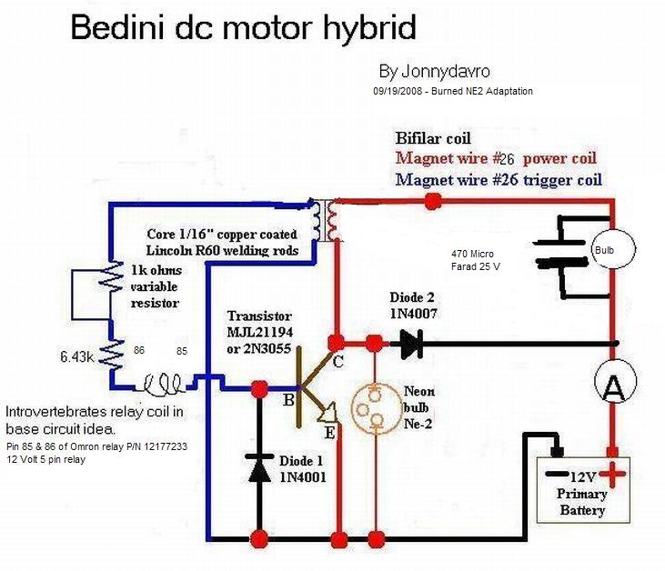

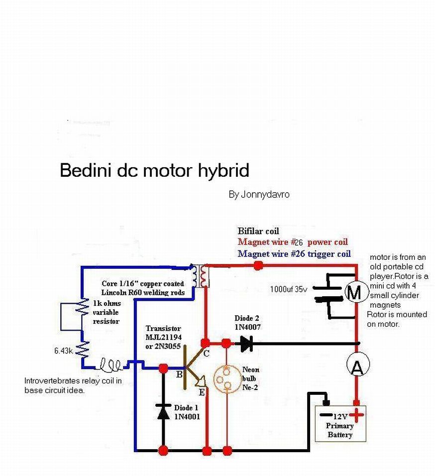

Hi,I have combined a dc motor with a bedini motor.The dc motor is in series with the power coil of my Bedini motor,my Rotor sits on this dc motor.
When i spin the rotor the bedini trigger circuit switches the transistor on which sends power through the dc motor and then the power coil.This does 3 things.
1.The power coil pushes the magnets on the rotor
2.The dc motor(rotor) spins.
3.The capasitor in parallel with the dc motor charges up
When the transistor switches off,the capasitor discharges through the dc motor so turning the rotor when a normal bedini would be free wheeling.
This hybrid motor is spinning really fast on 16mA but will run on a lot less but at a reduced speed
This motor has quite a bit off torque so i will be trying to turn a small dc gen with it.
