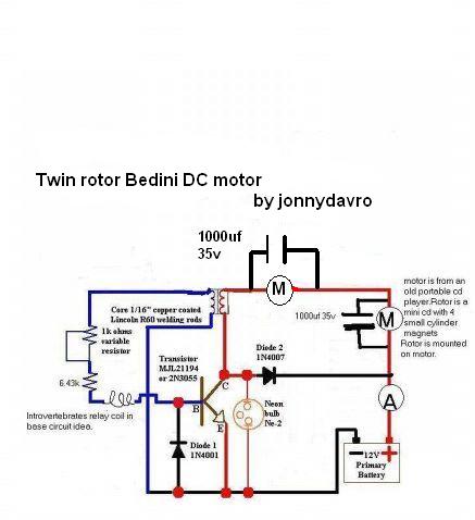

    Hi,Ive been working on Twin rotor Bedini motors for a while and i thought i would try this new DC Bedini motor in that config with some good results.
    1 rotor spinning drawing 18mA
    2 rotors spinning drawing 18mA
    I am getting 100% more mechanical output with the 2 rotors.I don't have a tacho but the wind down time is the same for two rotors as it is for 1.

    Hi,
    Would you answer:
    when you try to slow down one or both rotors on the motors with your fingers gently, will the 18mA current draw increase? and if yes, to what extent?
    Probably you have thought of generating electricity by induction with the rotary magnets, this is why I ask the finger load.
    Thanks, Gyula
      HI gyula,Ive just done the test you wanted.With only 1 rotor spinning I used my finger to slow it down and the current draw goes down.
      Regards jonnydavro
        this is good news!
        Hi Jonny,
        What you wrote is very good piece of news!
        Hopefully you will find current decrease also in case of both rotors loading at the same time.
        Now you can attach pick up coils around both rotating disks to induce useful power in them for a possible looping back to make a self-running setup!
        Hopefully, the normal Lenz drag by the pick up coils will not cause a significant change in the current consumption either.
        rgds, Gyula

              @guyla. Good news.I have done a load test with both rotors spinning and the current draw goes down.The important thing though is to place the same loading on both rotors or they will go out of sync.
              Regarding induction,i have thought about it but do you think my magnets are big/strong enough?
              @Burned NE2. The battery i am using is one i found, it reads 11.11v so could be considered dead.That said when i start the motor it drops 0.02v and sits at 11.09v but i think i need to get a new battery to do any subjective tests regarding charging as this battery won't charge via a normal charger,the voltage in it has come from a Bedini motor.

                Hi Jonnydavro,
                Many thanks for the good news again.
                Yes, your magnets now maybe too small hence not strong enough for inducing. I assume they are Neo grade 35? A bigger and hence stronger magnet set glued to the discs certainly would be better if you could furnish them.
                I would suggest three-three pick-up coils for inducing, two-two of them at the 12 and 6 o'clock positions and one coil at the 9 (at the left side disc) and one coil at the 3 o'clock position (at the right side disc).
                If you happen to have some multiturn coils at hand in your junkbox with ferrit cores that would be nice to hold near to one of the rotating disks and after full wave rectification see the DC output across a puffer capacitor how big it is (unloaded first). This is to get some insight now how strong or weak your present magnets are (with that particular coil from your junkbox).
                Coils with maximum 2-3 Ohm DC resistance each may be already fine, and you can think of connecting them in series and also you may use full wave voltage doubler rectifier to increase further the output voltage. If you need some schematics on this please tell.
                rgds, Gyula
