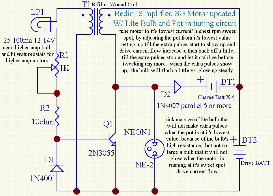

You are right, I take the neon off and remove the charging battery, but only for a quick moment, because without protection those 2n3055 fry fast (depending from the setup, of course). But that quick moment is usually enough to see how big the spikes are.
Aaron, you are right about the battery size, I have never really observed this effect on small 7Ah gel cells, but I can see it on my 50Ah car battery
