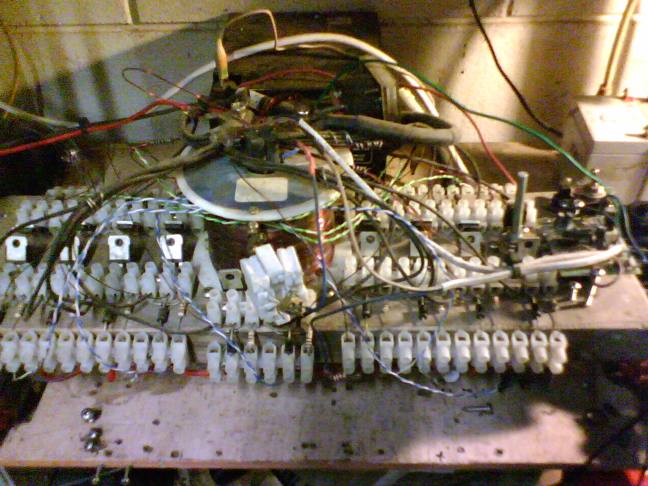

I have been getting interesting results by using a transformer on the mainsm stepping down to around 12volts AC, then a bridge rectifier, on to a beefy IGBT which is given a square wave signal from a commercial signal generator, presently 100 cps, the chopped 12 volts is then fed into a 50 volt to 240 volt transformer, into the 50 volt end, thus getting a high voltage spike from the 240 volt end. The charging of lead acid accumulators and reconditioning, is amazing, however the transformer is losing power when the frequency is raised to say 1000 cps, is there more to be gained pulsing at higher rates? how high should one go? I could get a dust cored transformer if there is more to be gained at higher frequencies. Any answers out there please
