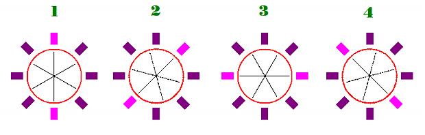

    Here's a picture of my four-pole monopole to illustrate the concept: The coils are positioned so that two coils are always firing in-between the travel of one magnet to the next, from the POV of a stator coil. In other words, with eight magnets around a rotor, you normally have 45 degrees of travel between magnets. But by putting a pair of coils (or a single coil for that matter) at 22.5 degrees, you double the kick that the rotor would normally get from a standard configuration. By extending this concept you can develop even more torque. You might want to draw your rotor/stator configuration with the magnets aligned with various coils to get an idea of exactly when things will be firing to know what to expect with that configuration.

      This is my setup.
      The yellow circles, except the middle one, are the cores of the coils. Rotor has 6 magnets each and stator has 8 coils.
      ImageShack - Hosting :: topviewpulsemotorzd0.gif
      And this image is the side view showing how the 2 rotors are connected to a shaft and between them are the coil spools on the stator.
      ImageShack - Hosting :: sideviewpulsemotoroq7.gif
      Then all goes in a pretty housing like so:
      ImageShack - Hosting :: rotorhousingfinishedtk8.gif
      • #18
        Interesting design; it should deliver some pretty good torque in this configuration. Interesting to note that while the wheel turns counterclockwise, the coil firing pattern will be clockwise. Let us know how it works out for you.
