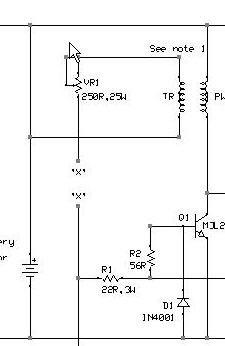

I do not use the FEG Page 46 solid state design. Mine just uses one feedback resistor as shown in the attached schematic. A big cap across the input supply rails is very important if a PSU is used because the charger will draw high current pulses from the supply. I have built the FEG Page 46 energiser and it works OK for small batteries.

Thanks for the schematic. I agree with you saying that small wheel energisers are good for reconditionning old sulfated batteries. I have found that for recharging large batteries they take too much time.
Is the battery shown on your schematic the drive battery or the charging battery ? What is connected between the two "X" marks ?

The schematic is a 'front-end' extract of my full schematic and shows the drive battery. The 'X' marks are the position for a normally closed thermal switch which disconnects my trigger circuit in the case of an open circuit output.

I'd realy like to build this circuit but a few things puzzle me.
I suppose the thermal switch is installed on the transistors heat sink and a neon is connected across the transistor's collector and emitter.
Unlike the Bedini SSG circuit, the drive battery + is connected to the trigger coil's south pole, so the coil is fed by the battery via D1 R2 R1 and VR1, why is this for ?
Is the vertical line that comes down the "X" mark on the schematic and connects to R1, connects somewhere else (it crosses the horizontal bottom line) ?

I do not use neons because I have not found them very effective at high power when using multi power strand chargers. I use transient voltage suppresors (TVS diodes) rated at around 188V (4 x 47V devices in series) directly across the charger output to ground. The thermal switch is bonded onto two of these diodes. See attached schematic which shows how the TVS diodes are connected to the charger output.
On power-up the transistor is biased hard on via the trigger winding, VR1, R1 & R2 to start oscillation. This gives the necessary very fast leading edge pulse every time the transistor switches on. This is a blocking oscillator and works differently from the solid state energiser shown in the FEG book.
The junction of R1/R2 (trigger bus line) is extended to feed the trigger to additional power transistors / strands. These are termed 'slave' transistors. The first transistor shown in the schematic is the 'master'. The base of each slave transistor is connected to the trigger bus line via a current limiting resistor the same value as chosen for R2.
